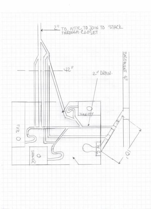

    thank you, ill try to upload my drawing for critique
    DIY Member christoff's Avatar
    Dec 2007
    Toronto Canada
    Default basement layout
    hope i got this right
    Jan 2008
    2,681
    Because your drawing is not isometric or 3-dimensional, it is impossible to determine if it is correct or not. Vent lines cannot be horizontal until they are above the flood rim of the highest fixture. Looking at the picture it appears that your vent lines are coming up in the middle of the room and the tub drain has 2 vents. You should also list all pipe sizes and declare what fitting is being used at each transition.
    Dec 2007
    Toronto Canada
    hi, and sorry the vent is going up the wall , all other pipes are in the ground, i believe i have 42" marked on the diagram for the flood rim where all of the vents join, the drain is 2" coming from all of the traps and the what looks like a second vent for the tub is the drain going to the 4 " main drain. not sure if this explanation helps or my layout is all wrong?

    Well umm that is a pretty hard drawing to try and figure out what you're doing.
    But if you plan on taking off with a vent inside the floor it either needs to be a wet vent or it needs to come off a nominally vertical angle which is 45* or more. So IE you need to come up inside a wall.
    I think you need to maybe post a better drawing, a more basic drawing. Or even a few drawings to show the different angels.

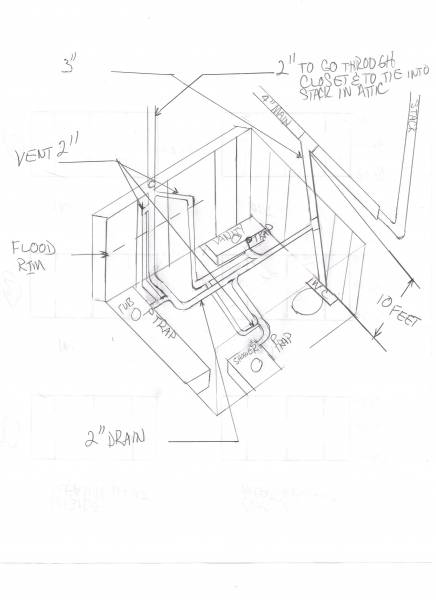

    i drew another picture i hope it is a little clearer
    12,445
    Lose all the flat venting.
    The lav drain should be in the wall behind the cabinet.
    They haven't allowe S traps since the 1920's
    Your're about 90 years too late.
    Sorry, but we just want to make sure that when you drill the holes, they will be correct.
    It would be a shame to run the layout and then
    1) have the inspector turn it down
    2) not draing properly.
    The Santee in the vertical wall shoiuld be vertical and come out of the wall at 18" for a 30" counter and 20" for a 32" counter.
    You can use 1.5" pipe for the trap arm.

    Terry is right. You need to get rid of all the flat dry vents you have in the floor.
    Do a little research into wet venting in Canada and you'll most definetly change your drawing!
    For that bathroom you could probably only get away with 1 vent, maybe 2. But you don't need 3 or 4.

    so, does this mean the distance from the vent that i willl be putting on the 3" toilet pipe(from the lav.) to the 4" sewer drain has to be no more than 10 feet? or is it the distance from the toilet to the drain.
    also the 3" has to be the last most downstream vented? thanks chris
    Jun 2009
    Penticton, BC
    812
    Quote Originally Posted by christoff View Post
    If you are wet venting the bathroom group then yes you must tie the toilet in last. If you plan on venting things seperately then it doesn't matter what order you tie them in.
    Your toilet flange must not be more then 10' from where the toilets waste line (called the fixture drain) connects to whatever is venting it. Be it a wet vent or dry vent it doesn't matter. You have 10' on your fixture drain.
