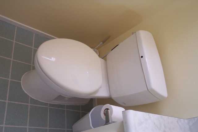

Thanks to everyone who participates regularly in these Forums, and to Terry for hosting it ! I now have two functioning Drakes, instead of two overflowing ones. Here is the latest one:
