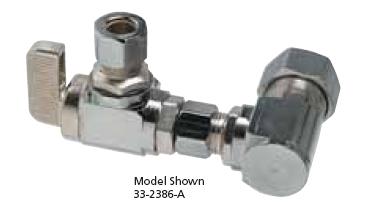

    I was leaning Carlyle, but our water supply is the standard 5.5" from the toilet centerline and 6.5" high, with the valve protruding 3" from the wall.

    I thought I read somewhere there was a close to the wall angled shut off valve, would that work with the Carlyle? Or would a 10" unifit help?

    Your options are:
    Solder a 90 el and 2" of copper pipe with shutoff,
    This is what we do most of the time. It takes very little space, and put the heat right on the fitting.
    Use the Dahl valve made for Toto, they are 1-1/4" from the wall. Sometimes you can sink it into the wall some.
    Use the 10" Unifit to move the bowl out 2" more inches.

    I'm an engineer, but not skilled enough to try the soldering so close to the wall. Unless the aquia is a one piece, I think I'll go with Dahl valve and 10" unifit to make sure I have enough room. With my boy's aim I may need the couple of extra inches to clean behind the toilet anyway. :-)
