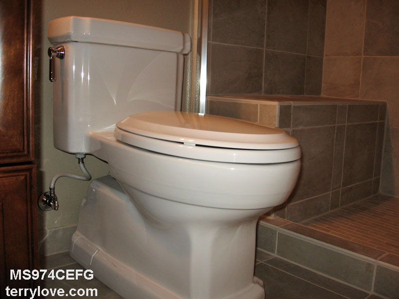

    Here are some pictures of a Guinevere installation. They are one of my favorite toilets. I like the Unifit adapter. If you ever need to pull the bowl and paint behind, you can lift up the bowl without disturbing the wax seal, paint, and then drop the bowl down again.
    Make sure the contractor has 1/4" drill bits for masonry. We carry a small roto hammer with us.
    Ready to drill the floor and set the Unifit with a wax seal.

    The base at the floor looks to be 12", so if you have the supply at the floor, it may need to be about 8" to the left of center.
    Higher up, the bowl narrows to 9.25", which means 5.5" to the left of center works if its coming from the wall at a normal height.
    I just went and measured the Guinevere that I have.
    Plenty of homeowners are installing the toilets with the Unifit.
    It just takes a good 1/4" tile bit.
    If the tile floor requires that the bowl needs shimming, then shim at the back before you tighten down the securing nuts.
    That's always the method, shim first, so that the bowl is stable and without any rocking, then snug down the nuts.
