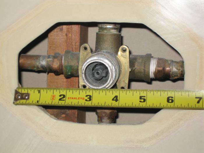

    Questions about upgrading tub/shower trim - will this new trim work?
    I want to upgrade our Avante Price Pfister series 09 tub/shower trim and have committed to finding out if it's reasonable. Given the location of our valve our plumber strongly advised we upgrade the valve rather than replace it and we agree. This means we will install a retrofit kit so the old valve can be used with newer trim and Price Pfister told me which trims will work with the retrofitted valve. Now my question:
    The picture below is the hole in the wall for the old trim with the valve behind it. The hole is 6 1/4" wide and 3 3/4" high. The surface in the picture is cultured marble. I should mention that there is no back access. The PP model that I think may work is the Avalon R89-8CBC.

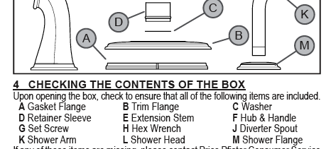

    The specs say the trim flange is 6.88". But there is no information about the size of the gasket flange (see picture below) so I don't know if I have enough leeway there for the gasket flange. Is there a standard thickness for the gasket flange. I need to make sure it is on the surface and not in the hole.

    If we proceed with this, we'll have a plumber do the work. What I need to know is if it is possible (that is the new trim would fit) and if it is reasonable (that is to cut the marble, if necessary). If it is, then I'll figure out about enlarging the opening, buy the trim, and call the plumber
    I want to thank you in advance for any help you may have to offer.
    23,534
    You either need a Price Pfister octagonal plate, which you probably would not find in the finish you are looking for, or a Larsen #31657 oval repair plate which fits behind the new round one.
