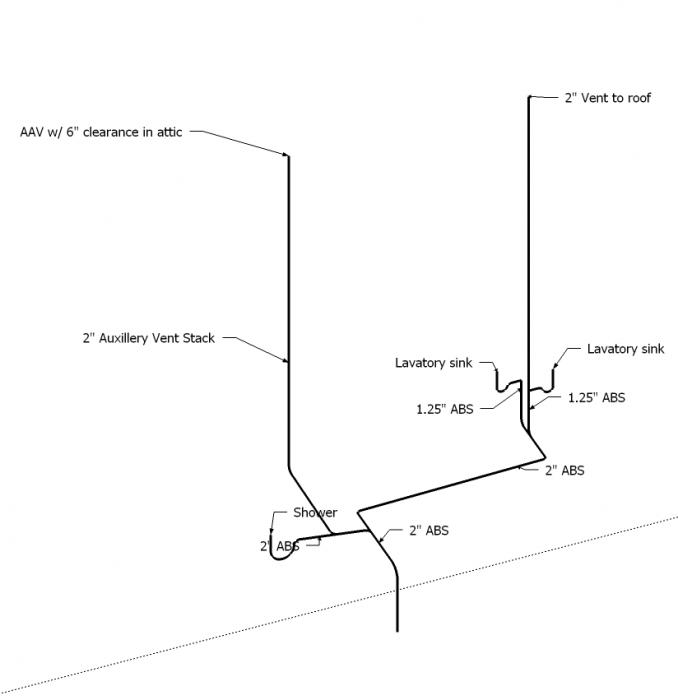

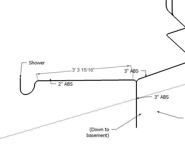

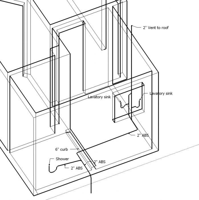

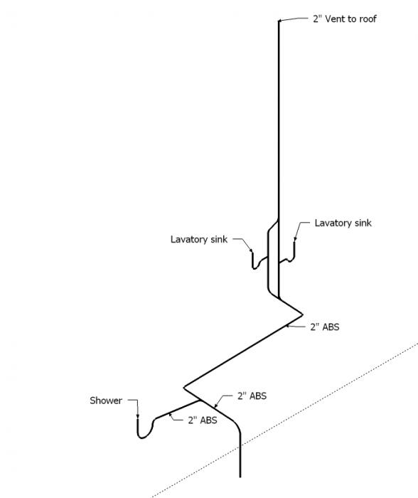

I'm installing a new shower into an existing washroom, however the vent stack for the existing drainage is located across the open room, which will end up being more than 6 feet away from the shower drain. However, where the shower drain is joining the drainage system is in between the down pipe and the vent stack. In the diagram included, I've added an auxiliary vent by the shower which would by vented by an AAV in the attic, but I'm wondering whether or not I need that since the pipe its joining is already vented.
Any comments on the diagram in general appreciated. Thanks!
