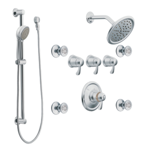

My husband and I are doing a complete master bath remodel, including moving all fixtures and adding a steam shower. This forum has already saved our bacon a number of times in the planning and process. I have our plumbing code just about memorized, but you all have much better descriptions. We also went with a Toto after reading on this site.
I finally have a question I don't see already answered. We are going with a Moen Exacttemp shower system. There is one thermostatic valve and 3 volume control valves. All the valves are 3/4" as is the supply. All the shower heads have threaded 1/2" connectors. The pipes between valve and head will be running an average of 5 feet. Am I better off stepping down to 1/2" right after the volume controls, or should I run 3/4" almost all the way to the heads? And why? I'm using all copper.

Thanks much. The install guide pdf is so much better than the one that came with the system. And it exactly answered my question. I'm not using body sprays, so thankfully don't have to worry about a pressure balancing loop.
I'm sure I'll have more questions before this project is done. Electrical work is so much easier for me than plumbing.
