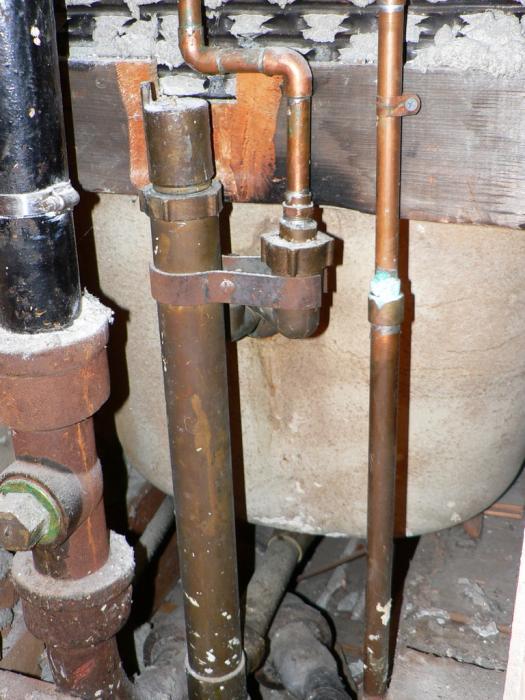

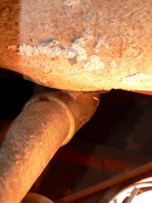

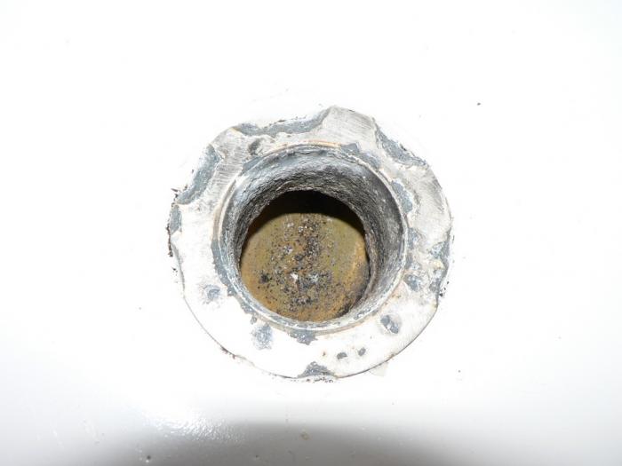

I am reviving this thread in advance of my attempting to replace the corroding tub basket in my 1920's-era cast-iron tub.
What is the likelihood of being able to remove the basket without destroying the shoe and, if the shoe remains intact, finding a matching basket or adapter bushing such that the whole drain would ultimately not require replacement?

Given the great amount of access you appear to have, why NOT replace the entire drain assembly?

From the looks of it I would say it hooks up to a lead trap. Not a job for a DIY call a plumber.

My DIY ability is limited, at best, to removing and replacing the basket. I would not attempt to replace the shoe myself.
I'm trying to determine whether to give it a shot myself or go immediately to Plan B (hire a plumber).

I don't understand the implications of a lead trap to a basket (and, possibly, a shoe) replacement. Could you kindly elaborate?

I guess the big factor then is how bad you need to use the tub.
If you take it apart successfully, you might spend days getting something to replace the basket with and it might or might not work when you are done.
If the plumber comes, he will likely cut out the whole works and re-do it.
I cannot see the trap in the picture.

What I'm looking at is to the right of the shoe in the picture. It looks like a wiped joint for the trap just off the branch of the cast iron Y.

I just looked over the setup again.
The trap was replaced at some point with plastic parts. It's fitted in between the lower end of the vertical pipe (to which the shoe output pipe connects) and the branch of the cast iron Y.

The tool you want is called a drain key.
The risks are that the threads in a tub shoe might be one of many, and you might damage the threads removing the basket. If you try to force the basket free, the shoe may twist and could damage the connection to the pipe.
Looking at the condition of what you have, you might want to consider just getting a new tub stopper and living with it until you are prepared to bite the bullet on a remodel.

You make a good argument against my proceeding with this project for now.
Nothing is leaking at the moment; The only thing driving this is the appearance of the basket. (I just had the tub refinished and I originally thought that I could find some sort of chrome flange to cover the basket.)
For the future, it's good to know about the drain key. But for now I think I will put this on hold.

I guess the biggest reason would be that he does NOT have an overflow opening in his tub. And given that it is an old "remote overflow drain", the odds of it having a conventional sized thread borders on zero as far as replacing the plug is concerned, because those drains were specific to each manufacturer. The difficulty of removing the plug has very little to do with anything other than HOW the original installer put it in. IF he used any sealant on the threads it will probably have to be cut out.

Thanks, hj. Your comments lend additional weight to my not attempting to remove the basket.
The "remote overflow drain" to which you refer -- Is that the section of vertical drain piping that rises above the normal water line and stops there?
Also, what about my original idea of simply covering the existing basket with some sort of chrome flange - something like this: http://tinyurl.com/473aplq
Would I just be asking for trouble by adding this (e.g., water pooling around the flange and not fully draining)?

When the tub was originally installed, the faucet had a center "knob" which was attached to a tube inside the "overflow" riser. When it was lowered, it closed the drain so the tub would fill with water, but when it reached a certain level, it would "overflow" into the top of the movable tube to maintain the water level in the tub. When the handle was rotated, it raised the tube, and then the water drained out of the tub. One feature of that type of tub was that the water spout was either where an overflow opening would normally be, or near the bottom of the tub. Either way, it was a potential source of contamination since the tub water could be "sucked" through the spout and into the water system. That potential for contamination still exists because you still use the "illegal" spout.
