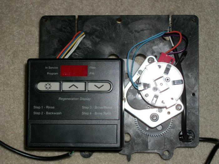

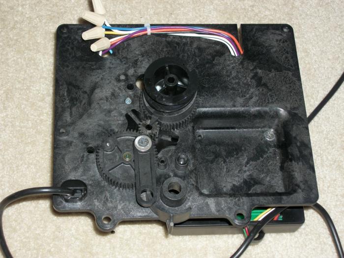

Size:  63.7 KBName:  100_0780..jpg
    This all started to resolve a leak/seal kit issue on a TwinFlo 100e last year. It uses the Fleck 8500 head.
    The seal kit resolved the leak, but we never got the unit cleaning itself correctly, undoubtedly due to various assembly errors. I have the head off now, and am looking for a resource to ship it to so that it can be evaluated, tested, and repaired if necessary. Pictures are attached.
    Here is a bit of history. When we changed the water seal, we failed (did not know) to cycle the unit to the proper cycle (Tank 2, step 3 brine rinse) before disassembling. That made it difficult to get the head off and on, and we may have damaged something at that time.
    One thing we know we did is WE LEFT OUT THE TRANSFER LINK. It ran for months without a transfer link, and only cleaned the tank (with a brine draw) occasionally. Mostly no brine draw or brine tank refill.
    We tested many injectors and screens,etc. but were never able to resolve it. Within the last couple of months, we realized we left the transfer link out, added that back in, but still had intermittenet performance.
    Then we noticed a broken tooth on the Cam assembly, replaced it, still no progress.
    Whenever the cam assembly rotates such that the tapered side depresses the brine piston, we get a brine draw, but that mostly never happens. Sometimes just by luck?, but not on subsequent cycles.
    My conclusion is that the gears and the electronic control are "out of cycle", and the unit is constantly confused. I had hoped that it would self-correct, but that has not occurred. Tonight, I accidently broke off the alignment pin on the center plate, making it even more difficult to attempt trial and error approaches to getting things aligned. Also, one of the plastic clips used to hold the motor clamp is broken, so that hangs precariously as well.
    Pictures are attached below.
    I'd like to ship the unit to someone who can evaluate it, replace the broken parts, test it on another system, and send it back to me positioned ready to go on to my system.
    Can someone refer me to a resource that can do this? I am located in Tennessee, but will ship wherever if necessary. Thanks in advance for your help.

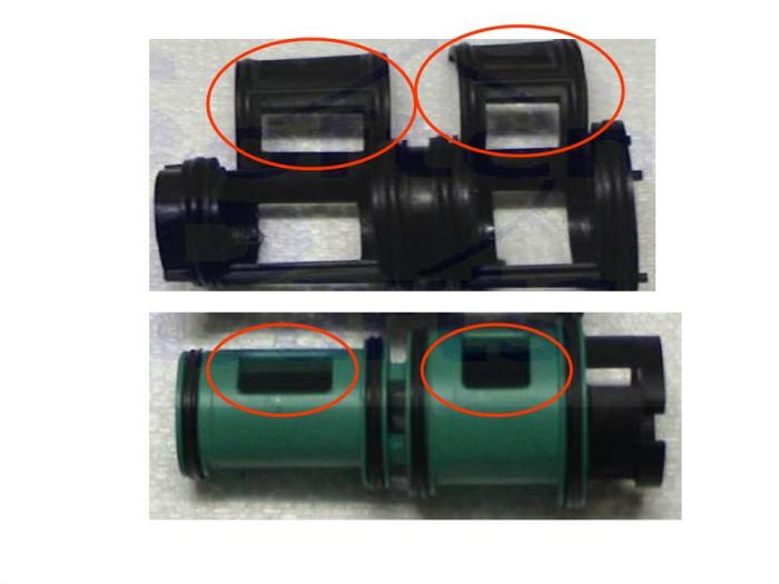

    I have a Fleck 8500 Control Valve. What is the correct orientation of the cage and rotor assembly during into the body during installation? The direction or clocking of the ports on the parts in relation to the body or bores. Thank you.
    Dec 2009
    Alaska
    1,329
    Another 8500....... arg.....
    The cage has the longer part on the bottom when it goes in and the two extra parts that might fall off when the cage is not in place go on the bottom.
    The piston has three openings at the front, the largest of the three is at the bottom for the little shaft to set into ..
    Which control is on the front of this? the SE or the older clock?

    So the cage should have the longer part on the bottom and the two extra parts (molded inlet and outlet) go on the bottom. Should two extra parts be placed at the bottom of the bore or 6:00 position? Looking at the original rotor or piston on the front face it has three openings - one a square cut and two have a 45 degree angle cut. Also the orginal piston has two large (round and oval) ports how should they be clocked in the bore?

    So for both the cage and the rotor the openings should be clocked to 6:00 area. The photo I attached shows the areas that I'm referencing. The original cage came out in multiple pieces adding to my confusion. Thank you.
    Dec 2009
    Alaska
    1,329
    The two doors or parts that came off the cage can only go back on one way, there is no other way for them to go on, then when the cage goes back in , another it can only go in one way, that little extra that it has needs to go on the bottom to be able to go into the open space in the bottom at the back of the opening when the cage goes back in.
    The rotor will have the openings on the bottom half.. it is what channels the water from coming in and go to either tank 1 or tank 2 depending on which side they are open to on the bottom half of a circle if you where looking at it from the front.
