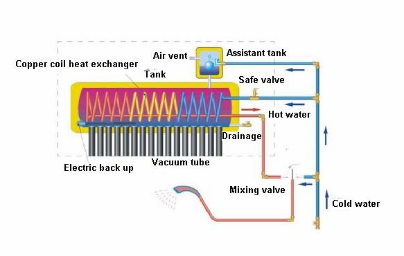

    Default vacuum tube solar water heaters
    Hi I deal in vacuum tube solar water heaters in Spain,
    A good way of installing a solar water heater and using your existing electrical cylinder is to pre heat.
    that means send the cold water line to the solar water heater and then bring the hot return back to the cold in of your existing electrical cylinder.
    You could always fit a by pass so you could use the hot water direct in the summer months.
    I am not sure what the climate is like there but vacuum tube units will work well all year round,
    I have a vacuum tube solar water heater fitted to my house , in the winter we get cold days but still have bright sunshine, the the cold out side temperature dose not affect the hot water production as long as the sun is out.
    Even if it is cloudy some heating will take place and if you pre heat to your existng bolier the will top up the heat and you will still save energy.
    I have a clip on you tube of one of my units boiling in the sun ( search -- cssolar1 )
    Regards tony importer for Deno solar equipment Spain

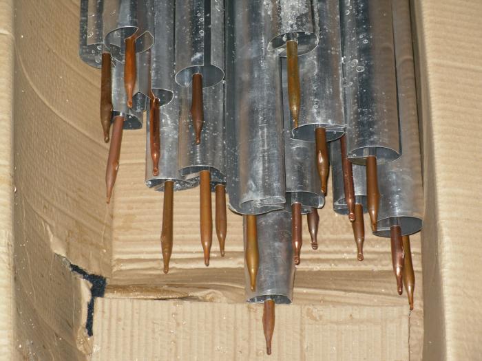

    DIY Junior Member mkiernan's Avatar
    Sep 2011
    Oklahoma
    this pic shows what happens to evacuated tubes in the winters of the usa, you have to spec that they have alcohol in them or they will split at the bottom when it freezes outside. this pic is from a customer who bought the tube type and regretted it big time.

    Default vacuum tube swh
    Hi
    Not all vacuum tube solar water heaters use heat pipes,
    The units I use have water in the tubes, anti freeze can be added as the unit is indirect.
    I prefer the water in tube type because it increases the hot water storage capacity also as heat is drawn from the unit cold water will sink to the lowest part of the unit which is the vacuum tube and remaining hot water will be forced up into the storage tank.
    Tony cssolar Spain
