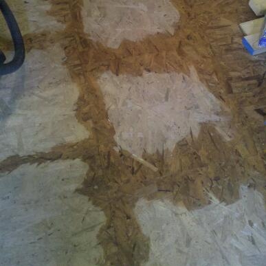

    I am remodeling/refinishing my basement in Connecticut. I have a question about putting down a subfloor. What would be the recommended or preferred way?
    (1) Put 1 inch XPS foam directly on the concrete floor then 3/4 or 5/8 plywood on top and tapcon both the wood and foam to the concrete floor.
    (2) Put down 6mm vapor barrier and use 1x4 pt sleepers with 3/4 or 5/8 plywood on top and use either 16 or 24 on center spacing for the sleepers. With 24 inch spacing can put 1/2 inch foam between the sleepers but there will be a gap between the foam and the plywood unlike option #1. where the plywood is directly ontop of the foam.
    (3) Put down a plastic dimpled membrane and put the plywood directly on top of the dimpled membrane.

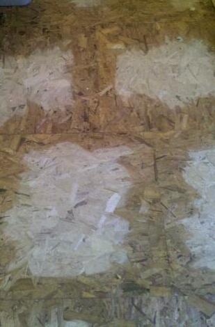

    I ask becasue Im replacing a dricore floor that failed due to water. The water must have wicked through the seams of the dricore.
    Im also adding a sump pump but Ill post those questions in the proper forum. Thanks

    OSB swells in the presence of water, so I would NOT use it for a subfloor. You are putting a sheet of plywood over the foam, so your weight will be well distributed over the surface, so it is not as if you were standing directly on the foam.

    I can't lose another inch in my basement, I'm using Delta FL with 5/8" plywood.
    OSB should be avoided.
    1" of XPS would be great if you have lots of headroom already.

    Delta FL is 5/16" so you end up with just under an inch above the slab with your subfloor. The reason I'm avoiding dri-core is because of the OSB.
    A good 8mil and 2 sheets of 5/8" is another good option and nets you 1 1/4" or so.
    I don't have any moisture issues at all in mine though, so my choice has little to do with vapor and water permeance.
    You NEED to take care of the water issue before moving forward.

    I am working on solving the water issues, sump pump, gutters draining into 4 inch pipes under ground and pipe running 100 feet away from house. Sealing cracks in floor, looking at drains around the sides of the house.
    But also want to do what is the best on the inside of the house. I'm leaning toward the 6ml vapor barrier, maybe put down twice in opposite direction, the 3/4 inch XPS pink rigid foam board them 5/8 plywood over that. Is the 5/8 the thinnest that is recommended?
    Water was never an issue before, but I dont want water issue again and just because this was a 100 year storm, doesn't mean its going to wait another 100 years.
