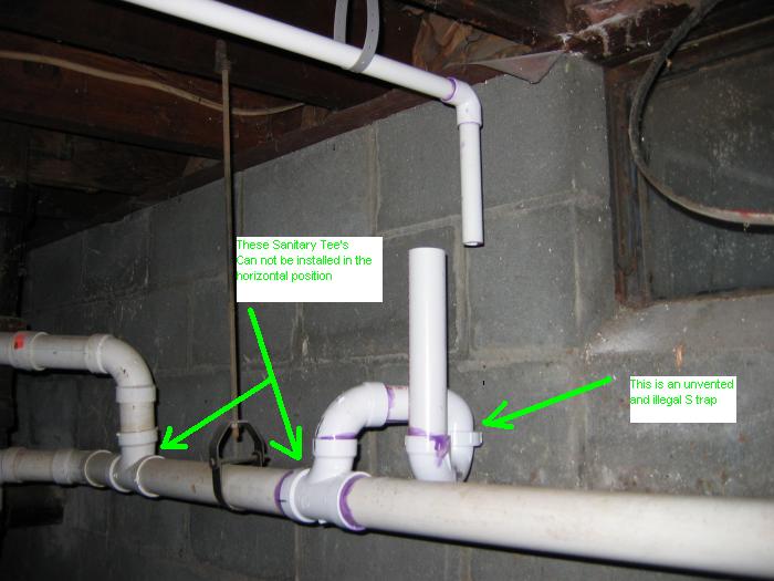

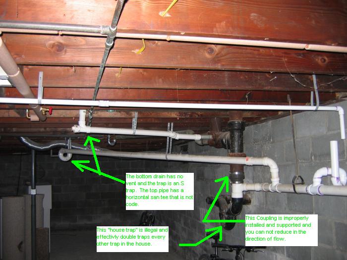

    Do any of you guys see a problem (s) with the DWV in these pictures? They are on the filters threads and I pointed out that there were some code violations there and I'm getting beat up over it.

    Looks pretty bad to me Wally.

    Yea, I was just trying to point out to the OP that the drainage was pretty messed up down there. take a look at that tub drain line. It must run a good 10 feet with an s trap and no vent. then there's that Fernco connecting the cast to the PVC which is a disaster waiting to happen.

    Nice hanger, though.

    Not a jole, the installer is a nice guy. All he did was cut in the 3 x 2 san tee and install the 2" trap. I'm sure he did it like that because everything else down there was done similarly. The OP just bought the place and if you read through the thread he wants to make things right down there. It's not the OP that was questioning my advice.

    A house trap is not "illegal", nor does it double trap any fixture if there is a functioning vent, not an AAV, anywhere in the system. The Fernco coupling is not permitted above the floor, but both pipes seem to be 4", the transition between the materials was just done improperly. The lables on the rest of it are correct as to the errorsl

    IPC will not allow the house trap. I know that it is existing but it really should not be there. The improper transition is the cause of the reduction in pipe size.

    But you did say this (emphasis is mine); "Actually, no, bad plumbing is never "grandfathered" and as soon as he cut into the lateral he is obliged to bring those other things up to code. Had he pulled a permit to pipe the drain, the inspector would have clarified that issue for him."
