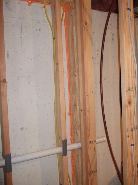

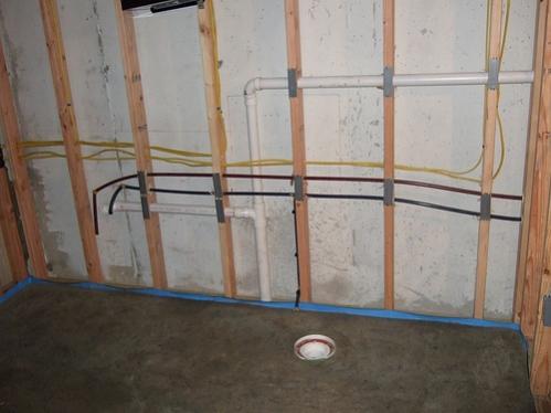

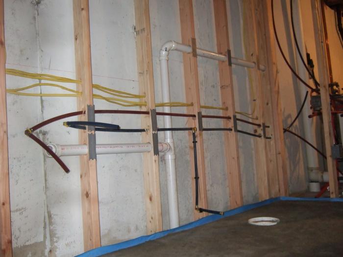

    DIY Senior Member mrmichaeljmoore's Avatar
    Jan 2007
    124
    Here are a few pics of what my wall looks like now.
    The gap between the back of the studs and the concrete wall is no more than 3/4”.
    Plus, it is all blocked off and fire foamed, so I can’t slide some 1/2” rigid foam behind it.
    Plus, as you can see, I have all the plumbing and wiring running through the studs…so not much room in the stud cavity.
    Like I said, I think I may go the no insulation route…...
    thanks for the help….
    mm
    Jan 2009
    01609
    1,980
    It looks like you have access to at least part of the band joist & sill in there- that should be spray-foam sealed/insulated before you close it all up. If you feel like it, a cobble-job of 1-2" of foam board glued to the concrete with a 1" clearance from the studs on either side will give yo more than 50% coverage- a big improvement from a thermal point of view, yet keep the studs from chilling below the dew point of the interior air. Spray or foam-board, either will do. Spray foam will be less labor, foam board less cost. With foam board good performance will depend on keeping it tight to the concrete (sealing the edges with 1-part foam or caulk wherever the gap is more than 1/8".)
    The most-critical/best-payback would be from the frost-line on up. But if your deep subsoil temps are below 60F there's payback on having at least 1" of foam on the lower portion too.
