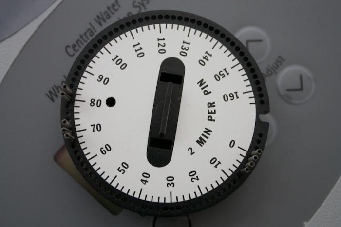

Does this mean anything? I am going to try to attach pictures of my dial setting and pin wheel for your review.

The part that you can read , the .5gpm is the flow rate back into the brine tank... that is good.
From what I can see in the pin/space settings,, 8 minute backwash. 60minutes on brine draw/rinse, 6 minute rapid rinse and 6 minutes or 9 lbs on the salt...
The Meter is at 1350 gallons with 1125 remaining before it trips into the next cycle.
Most likely there is a 2.0 gallon per minute backwash plug in the drain outlet...
With that in mind and the .5 gpm most likely in the brine draw/rinse part and the brine refill, you would use about 61-62 gallons in the full cleaning cycle..

Pin and space settings look good...
one thing that you might try for say a month or so is cut one space out of the brine refill... from 3 spaces to 2 spaces and change the meter from 1450 to 1900... then let things ride for a month or more and see how the water is... are there days that the water is a little hard? if there is then cut the gallons down 100-200 .. let that go for awhile again to see what happens to the hardness...
Are there times that the house fills up with people? goes from 2 to say 8 people ever?

I wouldn't set it up that way for 2 people and 3 gpg of hardness with no iron. Eleven or 16 days is too long between regenerations and it's using too much salt and water.
I don't recall the size of the tanks but I would do a regeneration of each tank with the max lbs of salt for the cuft of resin (15 lbs/cuft) and then program it based on 120 * 3 = 360 * 8 = 3K (3000/3= 1000 gals - those used per regeneration rounded down to the lower 25 gallons )and say 3 lbs of salt.
If you have a 2.0 gpm DLFC, you can remove it and see if there is a 2.0 or what the number is on it, that's the gpm. You can use the math formula in the manual to come up with the exact number of gallons used per regeneration (minutes times the DLFC gpm), and subtract them from the meter setting and round them down to the nearest 25 gallons. You do that because your meter dial is marked in 25 gallon increments.
And if you do the math right to get the programming right, you don't have to make a change and then use water for a few weeks or a month to see how it goes.
It doesn't matter how many people show up, however many use up the gallons on the meter faster than just the two of you normally do. The guests leave and you go back up to the on average once a week regeneration per tank. The down side of that is that your control valve does not do a purge rinse of the week old stagnant water, and in TX fairly warm water in the stand by tank before putting it into service. Frankly unless your household is using softened water 24/7, you don't need a twin tank softener and would be better off with a regular softener regenerating at 2 AM once every 7-9 days.
Your 10" x 48" is probably a 10 x 47, a 1.25 cuft (40K) per tank. Or an undersized 1.5 cuft.

You say that you have the book, on page 26 or so, 9000 control valve assembly there is the number 12 that is the brine, drain assembly...
Unhook the drain line, unscrew the fitting that goes into the injector assembly , there may or may not be a retainer, if there is remove, and then remove that rubber washer... on that washer there is a number , it is a bit of a challenge to read but it will say 2.0 , 2.4 , 3.0.... that number is the gallon per minute back wash that will go through the hole that is in that washer...

This should help;
do a regeneration of each tank with the max lbs of salt for the cuft of resin (15 lbs/cuft) [use 23 lbs] and then program it based on [2 people * 60 gals/person/day=] 120 * 3 [gpg]= 360 [per day]* 8 [days] = [3000] 3K [3k=] 3000/3 [gpg, to get how many gallons between regenerations]= 1000 gals - [subtract] those [gals] used per regeneration rounded down to the lower 25 gallons) and say 3 lbs of salt.
I would set the minutes of each cycle position at; 6 minutes [3 pins] for backwash, 46 [23 holes] for brine draw/slow rinse, 4 [2 pins] for rapid rinse and 2 [holes] for refill, and then 2 pins and all holes back to the beginning. The 2 holes refill is 6 lbs but IIRC you can't go one hole because the contact switch finger doesn't do well with one hole or pin but I may be wrong on that. You get 3 lbs per gallon of refill and .5 gpm or 1.5 lbs per minute. The gallons you set on the meter divided by 120 = the number of days between regenerations.
