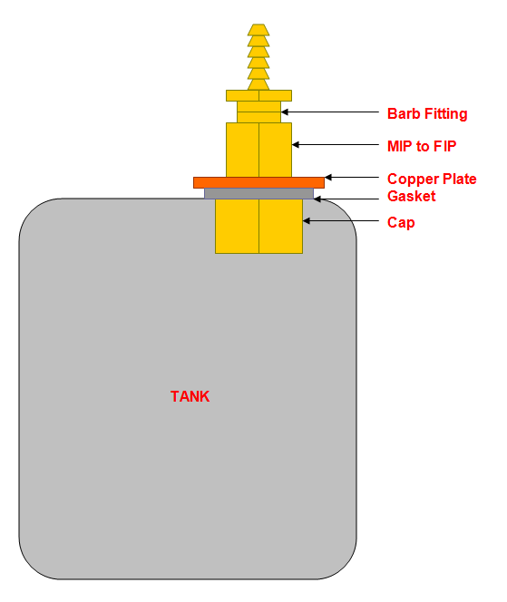

I have an ISE H-990 hot water dispenser that started leaking. The leak is coming from the seal between the stainless steel tank (model SST) and the plastic fitting attached to the top of the tank. The tank is a two piece unit, so after dis-assembly there is accessibility to both sides of the plastic fitting. Unfortunately it is an adhesive bonded fitting with no way to tighten it down to the tank. The fitting needs to be replaced. Initially I was going to replace it with a brass bulkhead fitting, but I have some concerns because some brass fittings have minute traces of lead, and the fitting will be in contact with water at 190 deg. F. Another option is a stainless steel bulkhead fitting, but I am having problems locating these. My question is, are my concerns relative to the lead issue in the brass fittings valid and if so does anyone have a source for Stainless Steel bulkhead fittings? The size I need is 1/8†pipe bulkhead fitting. The Clippard 15029-1 in brass is what I was originally looking at, and would work if I decided to go with brass. Thank you ahead of time for any information!

I enjoy repairing things, so even though I got a replacement tank, I ended up fixing the original. I could not find lead free or stainless steel fittings on line so took a chance and went to Home Depot to see if I could kluge something that would do the job. Home depot had a collection of Watts lead free fittings, but did not have a bulkhead fitting that I was looking for. They also did not have lead free brass nuts for the inside of the tank. So I improvised using three lead free fittings that I bought which were as follows:
MIP to FIP pipe bushing 3/8" x 1/4"
Female pipe cap 3/8":
Brass barb to MIP Adapter 1/4"
To make a bulkhead fitting I fabricated a copper plate (1" x 1") from copper pipe. Drilled required size hole in plate, and soldered plate to the MIP to FIP bushing to form a bulkhead fitting.
Placed gasket under plate and inserted assembly into the tank after enlarging the hole in the tank to the required size to accommodate the 3/8" MIP portion of MIP to FIP bushing ~.625".
Drilled hole into the female pipe cap to allow water flow out of the tank, and screwed it to the MIP side of the MIP to FIP bushing on the inside of the tank.
Screwed brass barb into the FIP side of the MIP to FIP bushing.
Installed tank and everything works like a charm. Here is a drawing of my repair.
