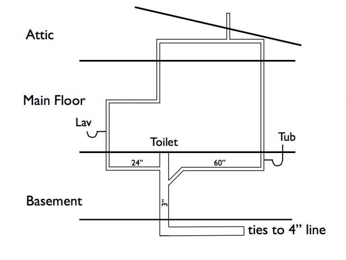

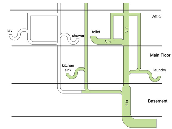

Thanks guys... I've included some pictures to clarify what I was trying to say. It's a main floor bathroom remodel (second picture) and I'm keeping all the fixtures in the same location, just replacing cast iron with PVC and adding vents (nothing was vented before). I'm trying to vent the toilet through the lav and the tub will have its own vent. Currently the toilet sits on a 3" pipe that drops through the basement and ties to a 4" line which catches a kitchen, laundry, and bathroom (first picture - that project is done!)
The reason I ask about using a wye is that the tub and lav come in at similar levels, but different angles to the stack. If this configuration is not allowed, is there another way to do it?

NHmaster
3,176
S. Maine
That you can not do because when the toilet flushes it blocks the drain and vents for the lav and tub

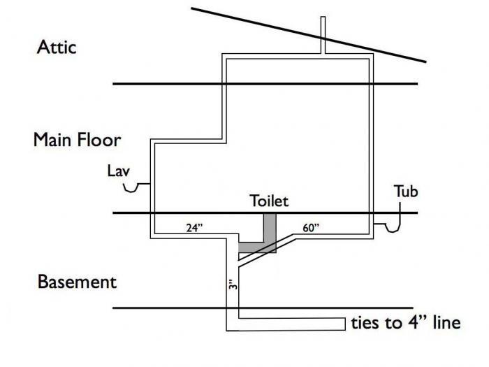

I thought it seemed a little odd to have the toilet like that. I can put in a 90 and sanT - it just means I have to break some concrete to move the stack over a bit. Right now the toilet is directly above the soil stack. Does the toilet tie-in go below the lav drain and above the tub drain as drawn? And is that wye to the tub OK or does it need to be a sanT?

Doherty Plumbing
Journeyman & Gas Fitter
810
Penticton, BC
www.facebook.com
You need to tie the tub in upstream of the toilets connection to have a proper wet vented system. But you guys DO have DIFFERENT rules for wet venting then us Canadians so I can't say for sure that it would be acceptable under your code.
Edit: Nm I just looked that picture a little closer. The way you have it now would be acceptable under Canadian code because you are simply wet venting the toilet through the lav and the tub is separately vented.

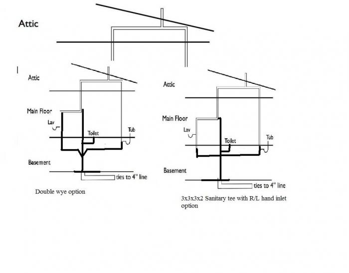

You can use a double wye below the sanitary tee to pick up the tub and lav. Another option depending on your code is to get a 3x3x3x2 sanitary tee with right/left hand inlets to pick up your entire bathroom. You can also try to offset the stack with two 45 degree elbows instead of breaking up the floor and moving the stack. The drawings I provided would work under the Chicago code however check your local code.

33,603
1,042
Absolutely NOTHING wrong with the second picture. A vent only starts working AFTER the flow has passed the vent connection, not while the water is flowing. As long as a fixture has its own vent you can connect it to the system any way you feel like it. Just do not drop too far out of the toilet before making one of the connections or the toilet will flush so strong that it will suck everything within 6' of the toilet down the drain. What is the purpose of the first picture, however, since it seems to have NOTHING to do with the job you are asking about?

Thanks for the drawings, JC. I'm trying to avoid running a vent behind the toilet due to some joists that are in the way. This forces me to wet vent the toilet through the lav... I do like the idea of offsetting the stack.
To avoid the super flush problems that HJ and Peter were talking about, I guess the layout in post 7 is better. It sounds like it will work in Canada... are there any problems with it under IPC? Would it be better to bring the tub drain into the stack before the toilet?
You're right, HJ, I probably don't need that first pic in post 4. It was just to show the rest of the plumbing downstream of the bathroom in case it mattered.
