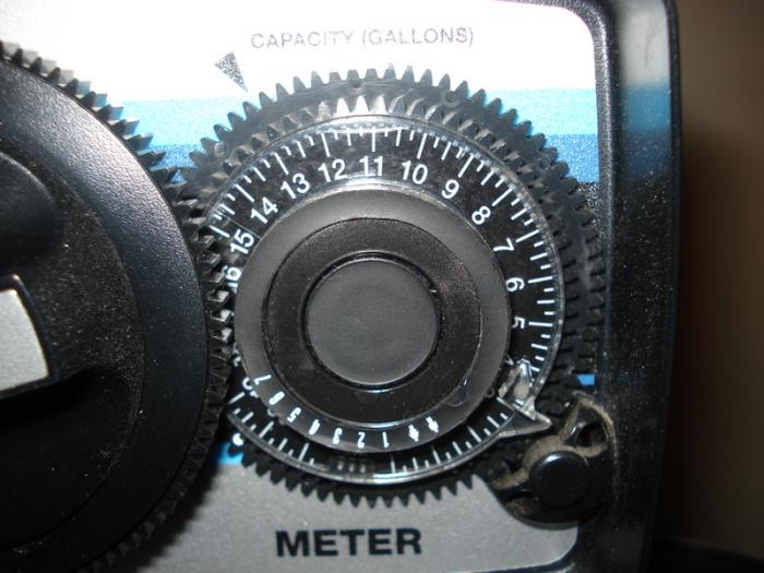

    I think I got a deal on this water softener (I think it's a Fleck 5600) and since I'm doing it myself and know nothing about water softeners other than I gotta have it, I need some help dialing in the settings.
    I'll try to attach pics so you can see what I'm working with. Right now I have to manually regenerate because we can feel the hardness in the water develop before it regenerates on it's own. Obviously, the settings are off.
    So what do all these dials do? And what should they be set at. I don't know what the hardness of the water is. I can call the City tomorrow if need be. I'm in Southern Utah.

    Here is a link to the manual on that valve ..
    http://www.pentairwatertreatment.com...al%2042447.pdf
    When you get the hardness from the city let me know....
    Along with the number of people in the house, size of the media tank, like 8x44 or bigger.... and any thing else that you might know about the unit... like is there a tag that says Turbulator on the top of the control?

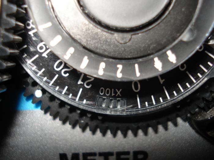

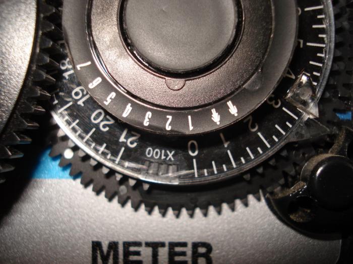

    See the white dot across from 1975? That is the number of gallons it is programmed to provide between regenerations. That is based on a number of pounds of salt used per regeneration an that is set in the back after removing the back cover.
    Since you are on city water, you need to know the maximum hardness in their system. You can look up their web site or call them for the maximum hardness in their system, not just your area.
    Once you know the hardness you use a math formula to program the valve. You can click the link in my signature about sizing to find the formula and then come back and post your figures and we'll tell you the rest of what you need to do.

    OK The water hardness is 15 GPG. The tag on the tank says the size is "948". Not sure if it's a measure of cu ft, cu inches, or what. The size of the cylinder is approx 9X48.
    Our usage is approx 5000 gallons per month. Only two of us. The manual emphatically says dont mess with the factory settings in the back of the unit.

    Ok, you have most likely 1.0 cubic foot of resin..
    On the back of the valve is a plate, there may or may not be a lable with the salt setting, if not remove that and look at the wheel that has a salt setting on it... more infomation is in the book
    http://www.pentairwatertreatment.com...al%2040106.pdf
    It will show you where that setting is at and how to change not only that but also the meter..
    Based on 1 cubic foot, 2 people, and 15 grains I would set the meter at 1200 gallons .. let that ride for awhile and see how that plays out, if in a few months you find that you either have to send the unit into a cycle or have hard water, look at where the meter is at when you send it into an extra cycle.. if there is say 200 gallons left on the meter, take the 1200 and change it to 900 gallons.. But for now I would say make sure that the salt setting is at about 9 lbs, and that the meter is set for 1200 gallons.

    Is there any iron in the water? I set my 1 CF units at 8lbs salt (this gives 20,000 grains of removal). So the math would be 20,000/15 gpg hardness = 1333. So I would set it for 1300 gallons. If you have iron, the gallons would change.

    First, it is a new system so no worries there. The salt is preset at 9 lbs so based on all the above I'll start at 1200 and see what that does for me.
