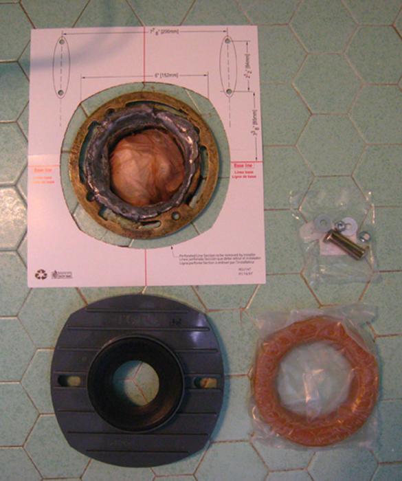

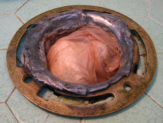

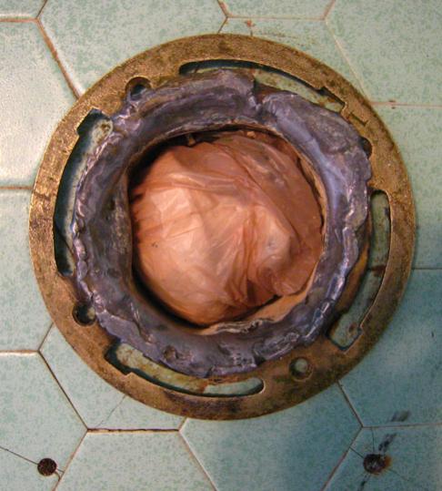

I am installing a new Toto Aquia II toilet in a 50+ year old house. The sanitary lines are cast iron. Here is a picture of the existing flange which is brass with a leaded connection. Note that the flange sits above the tile by about 1/8" to 3/16". I would like to know the following:
1. Is this in an acceptable condition to proceed with new toilet install?
2. If not do I need to install a new flange?
3. Should there be shims under the flange?
4. Do I have the right materials?
5. Any other recommendations?
Just want to make sure before I find out after I install everything and have problems.
Note: Included is a picture of the Toto setup materials to be installed.

It's normal to have the flange on top of the finished floor, so I think you won't have any problems. As long as the lead is not split. It would be nicer if it was smoother around the flange, but the wax should compress and fill in to make a good seal. See what the pros have to say...

As jadnashus said if the lead is OK you should be good to go, just be sure you screw the flange to the floor.

It is Interesting that the flange wasn't screwed to the floor originally. I am guessing that I need to shim the flange at the anchor points to keep from stressing the connection. Any recommendations for drilling tile?

There is NO connection. The brass flange was just slipped over the lead bend and then beat down to make a funnel/flange. Screw the flange to the floor then use a piece of wood to hammer the lead down against it. It does appear that the lead has at least one hole in it, but the wax ring should cover it, or use a solder gun, not a torch, to to close it up.

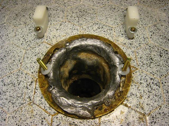

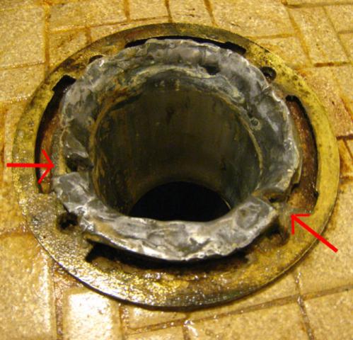

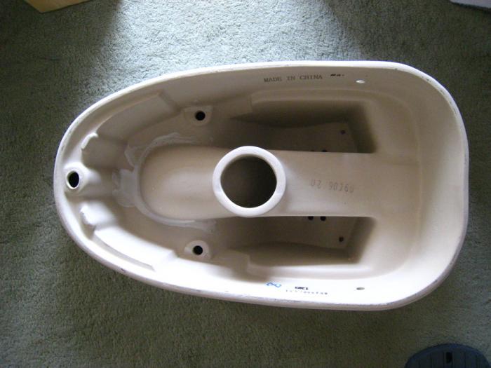

Installation Complete for 3 toilets
Thanks to everyone's support, I completed the installation for 3 toilets. Attached are images of the toilet installation and the other closet flange conditions. All toilets are working well. The soft close seat is highly recommended.
2 of the 3 toilets had soft tile that was easily drilled with a carbide tip. 1 of the 3 had super hard tile but I managed to muddle through with the carbide. Yes, the diamond tip would have been better.
