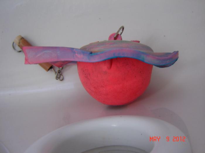

    As the rubber ages, the dome on the top collapses, this pulls in the edges. There are other companies that make flappers that fit. It all depends on your water chemistry...some last a long time, some don't.

    Have 3 ultramax for 6 years and started leaking lately after a series of clorine tablet applications to 3 toilets. Out of the 3, 2 toilets started leaking and found out that the flapper was defective. Showed wavy edges on the flapper. I had to agree to one of the previous poster that the flapper needs a solid flapper instead of the pure rubber flapper. Bought the fluidmaster flapper at Lowe's. HomeDepot does not carry it. Here's a picture of the defective flapper.
  8. #38
    12,432
    Chlorine voids all manufacturers warranties. We're not surprised that adding chlorine did that to the flapper.
    Plumbers tell homeoweners about the damage by chlorine all the time. Fluidmaster does make a product that will put the chlorine inside the refill tube, bypassing the tank.
