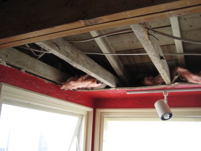

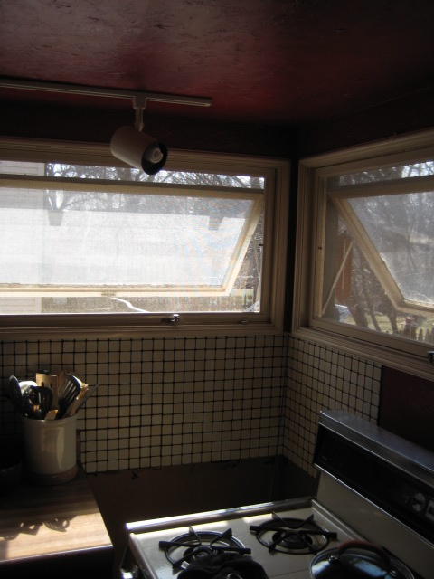

    I uploaded a couple of pics to show my space, the one shows the right corner, above where the sink will be, but gives an idea of the vault I'll have. The lower 2x4's will be coming out. The other pic shows the corner where the new stove will be placed once the remodel is complete. *note- the stove in the picture isn't where the new stove will be. When I get my new cabinets made, the stove will be 90* from this one and back in the corner centered under the window.
    Do not believe you will find that building code allows the stove under a window.
    Looks like you could vent through the roof.

    Quote Originally Posted by PEW View Post
    Can I ask why that is? I don't have any other real options.
