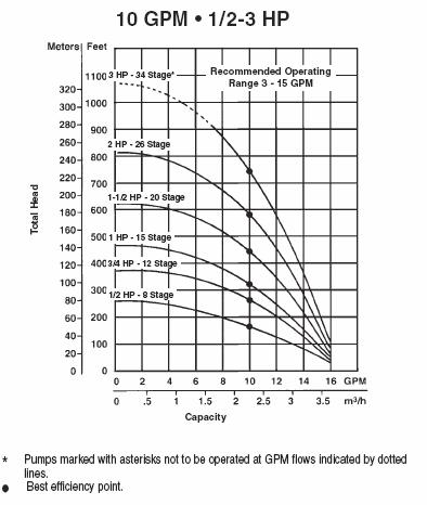

  7. #22
    6,356
    Quote Originally Posted by Akpsdvan View Post
    Does not what?
    Handle the flow or the treatment?
    The resin won't remove all the hardness when the constant SFR gpm of the volume of resin is exceeded.
    And I see you are saying that if the pump is a 10 gpm, he can't get more water than 10 gpm.... without knowing a lot about the well etc. that is false.
    Here is a pump chart to prove it:

  10. #25
    Dec 2009
    Alaska
    1,329
    Thought that we where talking about Peak flow, not constant flow... if I was doing 12 gpm flow 24/7 then it would be either a 2 cubic foot or 2.5 cubic foot and a 1.5 inch valve... and I most likely would dump the turbo because of a max flow of 17gpm. But the sizing of the unit would also have to work with the flow out put of the well pump....... only a fool puts a unit needing 12gpm backwash on a 7gpm well pump.
  11. #26
    DIY Junior Member scooby074's Avatar
    Feb 2010
    Nova Scotia
    24
    ill have to try and get the specs on the pump/\ cant say about the depth, but ill guess 60 ft. this is based on opinions from the softener reps.
    i can say its a 1/2 hp and its a jet pump. but actual GPM i have no idea.
    i wish i could tell you more, but the house was a repo.\il
    considering the whole place will be new, low flow fixtures i dont expect to exceed 12 gpm draw.
    so the turbo isnt recomended??? i thought it would be cheap insurence if it improved the resin bed operation.
    ill pass on the carbon until i know how the water tastes. an undercounter RO might even be a better idea at a later date

  14. #29
    6,356
    While there may not be the iron to justify... the turbutator Will keep the resin cleaner along with using ALL of the resin, unlike the normal dist that will only use 60% of the resin in the life of the system.
    Think of it as an up side down cone...
    Yes the upside down cone happens with all softeners that don't have a gravel underbed. Those that do have the gravel underbed don't have that problem.
