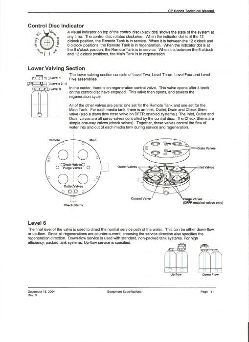

Might you be talking about a valve like this one?

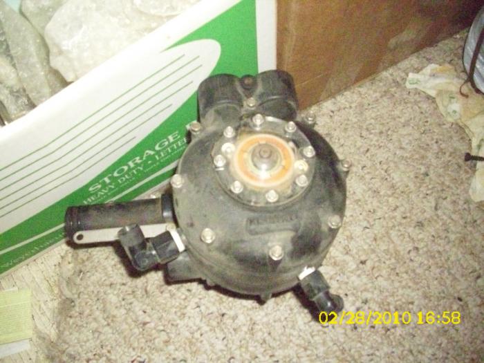

Akpsdvan
1,542
15
Alaska
This one has orange and 2 on the dial that is under the clear.
Yours?
