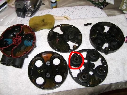

    I swapped out the pre filter and now I'm only getting water if the softener is by-passed. Do I have air in the system? What I'm I missing?
    Thanks for any help,Tony
    There is a plastic rocker inside the valve that, if broken, will not allow water thru the unit. I have a picture of it but don't know how to post it.

    Quote Originally Posted by Skip Wolverton View Post
    It worked fine before the filter change but now I only have water on by-pass. I could have damaged the valve somehow?

    What kind of bypass for the kinetico?
    Did you bleed the air out of the pre filter after the filter change?

    Quote Originally Posted by Akpsdvan View Post
    No, I did not.
    That did it! Thanks a lot for the help.
    Yes the plastic rocker can break at anytime. When broken, it causes both pistons to close shutting off the water supply. The rocker is the ones in the upper right side of the pic (small piece). Thanks for the help.
    Brake at ANY time?
    Och....
    Is it a fail safe idea?
    Why would some thing that could cause that much trouble still be in use?
    IIRC when it switches tank, the rocker forces the opposit piston to close preventing water flow from the tank in regen. They do break easily with age.
