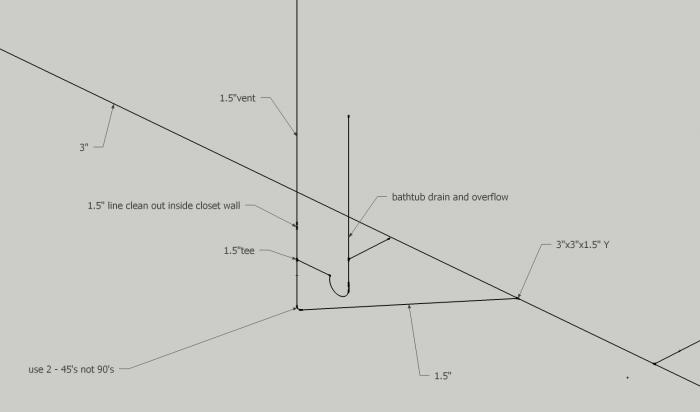

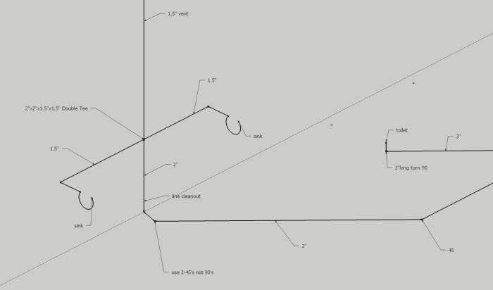

here is a top view of what you may be able to do if local code permits. use a double tee to connect the two sinks and this will wet vent the toilet and shower through a double y fitting. check with inspectors to see if local codes permit this. then vent the bath on its own through the wall near its drain

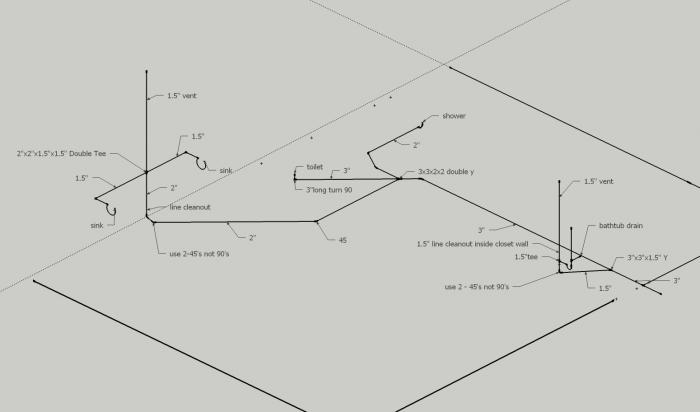

tuffy
British Columbia
here is isometric. If you are not absolutly sure of how this goes together or if codes for your area dont allow this then you may end up spending more than it would cost to get it done professionally. once you glue together fittings they are basically garbage if an inspector tells you it is wrong. As HJ has said... you may not interperet this isometric correctly or some unforseen obsticle will make this not work correctly and you could end up with a lot of fittings for the trash heap and could end up paying a pro to do it anyway. Draw it out and take it to inspector to see if it even passes their codes.
Keep trying different plumbers. You may find one that will just guide you
good luck with this

Ryan_Z71
11
South Jersey, USA
I wish I could thank you in person!
Tuffy,
I worked from what you provided and was issued my permit yesterday! All that was requested is that the shower be vented by itself. I went to the plumbing supply today and purchased the fittings and cement. I asked the inspector if there was any chance he'd be willing to review my piping in dry fit. While he didn't agree, he didn't disagree and said to call him when I get to that point...
Thanks again for the help! I appreciate the time you took!!!
Ry
Ryan_Z71
11
South Jersey, USA
Haven't been by in awhile, but a quick note following up. Thanks to Tuffy's guidance, I made a successful install only needing to add more support hangers and raise my vents above the roof an additional 6" (probably because of this past winter's accumulations) to get the approval.
