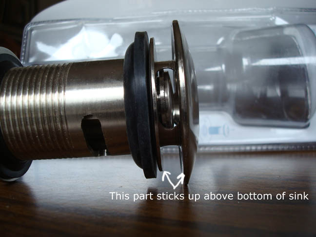

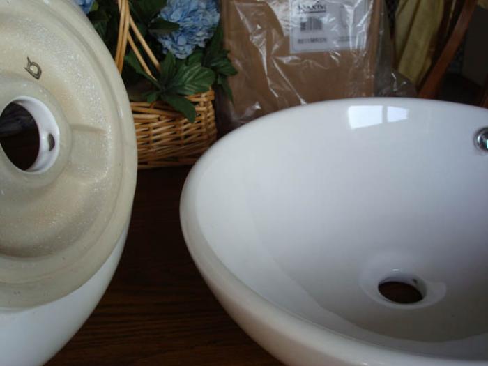

I purchased two vitreous china vessel sinks last week. i didn't order the drain assembly at the same time beacuse the sinks didn't say what size the drain holes were (1-1/2 or 1-3/4). So I received the sinks and meaured the opening (it's 1-3/4 inches) and went to HD to get the drain assemblies. Note that my sinks have overflows.

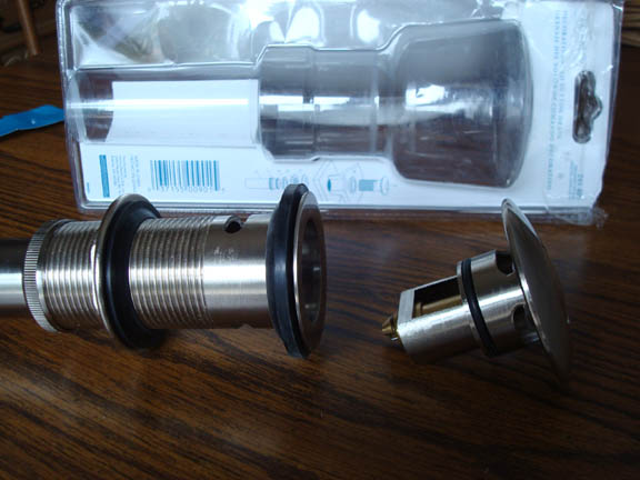

HD sold me the drains in the pictures (pop-up drain for sinks with overflow). I tried to instll the drains but they don't seem to work/fit. You can see in the pictures that if I insert the drain into the sink and tighten dowm the nut, the brushed nickel piece with the pop-up drain button sits about 3/8" off the bottom of the the sink. I don't see how this could work plus I don't like the looks. Did they sell me the wrong thing or am I not understanding how to install this?
The drain is the only think that holds the sink in place so the big nut is used to tighen the drain to the sink and the second big nut secures the sink/drain to the counter top. Maybe some plumber's puddy or silicone is used too - I don't know.
The piece that is shown out of the drain tube (pop-up drain assy) only slides into the drain as far as shown in the bottom picture. I stops against a machined shoulder. I want the top of the pop-up drain head flush with the bottom of the sink.
What kind of drain do i need?

The gasket that you have on the top of the assembly goes under the sink. In place of that gasket, you place plumber's putty.
this assembly is designed to sandwich the vessel sink and your countertop together so it doesn't move.
1. place putty under the top lip of the assembly and insert into sink hole.
2.next insert first large gasket up against the bottom of sink.
3.place sink over top the countertop so that the first gasket sits firmly on your top and the drain assembly penetrates through the top.
4. Now install the last gasket and nut inside the cabinet and tighten everything together.
Thats what it looks like anyway.

Athough your sink has an overflow, as does the drain piece, the sink bottom is quite shallow and looks like it will require a special drain. You may have to buy the drain from the same company that made the sink.

Your popup has a "hood" to cover the opening. The drainage takes place into the perimeter of the "hood". All you need is a standard popup drain with an exposed pop-up plug. One advantage of the hood is that it breaks up the aerated water stream coming from the faucet and thus will usually have a better drainage rate.

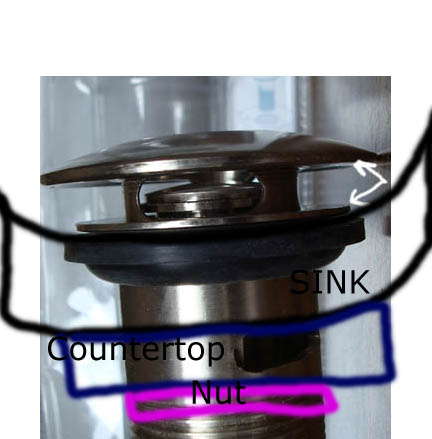

Okay. this is a crappy drawing/photo but I hope this helps me ask my question. As hj noted the sink is thin for a sink with an overflow. I had the supplier send me a drain. I don't know if it will work. The new drain does not have the hood (which I like) but the slots for the overflow do not fall within the sink body itself when the drain is put in place. Meaning the overflow slots fall into the space under the sink and inside the granite. This would mean that any water overflow would drain through through the sink body and into the space between the bottom of the sink and the bottom side of the granite - which is sealed by the rubber washe. Could this possibly be the way the sink and drain are supposed to work? It seems it would work but it doesn't seem correct.
In this idea, the nut has the big rubber washer on top of it sealing the drain to the underside of the granite countertop (not as shown in the photo). The popup drain head would be flush on the bottom/inside of the sink with some pluber puddy under it. The sink would be installed with plumbers puddy under it sealing it to the top surface of the countertop. Will this work?

Sorry to be a bit off topic, but my first thought is that every time something small is dropped into the sink it will slip under the hood and be hard to retrieve. Worse yet, it might go unnoticed and be gone forever.

I agree that the hood sounds like a bad idea. I sent the first one back and received two more. Both are similar (no hood) in that the overflow holes are about 3/4 from the bottom of drain head and my sink is about 1/2 thick. i thought this was aproblem but now that I am studying the problem, I am beginning to think that the granite must be considered part of the sink body.
The bottom of the sink is flat (except a groove in the ceramic for a bead of plumbers puddy). So if the nut were to go directly on the bottom of sink, the granite countertop would need a cut recess to accept the nut. And there would need to be a second nut under the granite to mechanically hold the sink to the countertop.
This is probably obvious to a pro, but this is the first time I ever saw/had a vessel sink. Should I just put the tapered washer against the (rough) granite and tighten it up, or should I put some silicone around the hole first?

A proper drain would only allow the overflow to drain into the the pipe, not into the space around the countertop hole.

Not unless you can find a way to properly seal the mating surfaces at both the top and the bottom of the counter top. It will be very likely to fail as if the bowl is bumped hard enough it may break the seal.

This install sheet for an American Standard vessel cabinet shows that the drain assembly is purpose-built.....it has a long threaded shank, and two nuts are used....one to secure the drain into the sink, and the second to secure the sink down to the counter top. So we are back to the fact that your drain is not proper for that installation.
If you installed it as shown in your pic with the overflow hole below the bottom of the sink , a leak is just about guaranteed.

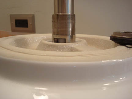

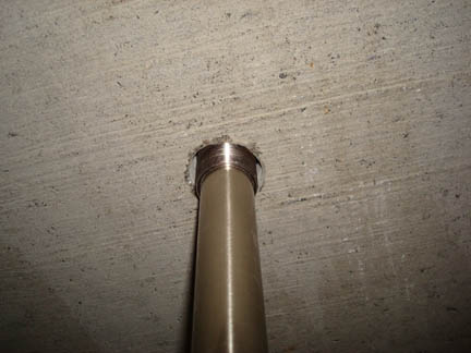

Thanks for all the help. I was able to order two drains without the overflow and drill the overflow holes where I needed them. That took care of the drain overfloe hole location issue. I got the sinks installed and luckily had enough thread sticking through the granite that I was able to use the nuts from the "old" pop-up drains to secure the sinks (as the "new" drain nuts where used to secure the drain to the sink itself) to the countertop. I used a scap piece of tile and drill a hole in it so the nut/tile would tighten up against the underside of the granite. It was more work than it should have been - but its done now.
