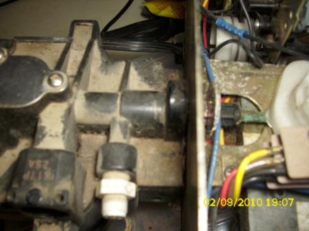

Here is what I found. The screen is definitely dirty and somewhat plugged. Could this be why the brine tank is filling curing wrong stage? Or is this an additional problem. Really looking forward to your reply. I feel like this is progress.

The screen is one part of the challenge, when the metal plate came off, did water come up and out of the injector? where the screen came from?
If that screen is dirty, then there is a very good chance that the screen on the brine piston is also dirty and may be adding to the challenge.
The injector is a 2 part item, there is a smaller part that is in the larger part that you see with the 4 parts that hold the screen. It does all come out if needed, or you could use a paper clip .... straightend out and pushed down in the middle .

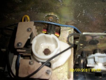

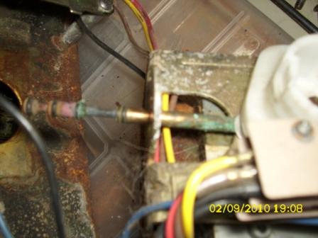

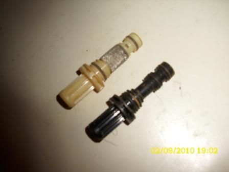

On the brine piston that is just under the cap that you removed , running from the control plate to just under that injector... there is a screen that is on the back half, there are 3 O rings on that either black or white plastic cage... there is the piston that will come out when the front control plate with motor and timer come off... that plastic piston will have 4 Orings...(I think, been awhile...)
I got some of it right....

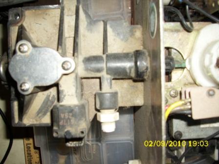

Here are some photos..

Ok. This is what I have. The brine piston came out fine. It has 5 o-rings and they look good. I removed that cap again and pulled the screen, then the injector, and then that next piece. It has two o-rings and loks ok, just dirty.

Items do look like they should be good, the blue item, make sure that it is clear.. you did check the cage for that brine piston?

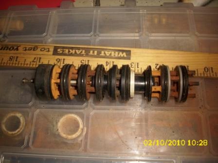

If the brine piston end was tracking with the white cam and the brine injector piston area is clear and clean, then the only other spot that could be of a challenge is the Main Piston and Seal cage.. one of the O rings around the main piston has a cut, not in place..main piston.JPG the photo is of the main piston, the white seal is one of five.. one or more could be the reason for the fill of water to the brine tank when it should be pulling.

Reviving an old thread.
attachment.php
Is the pic above from a Medallist (previous page)? Mine is different, I think. Maybe this one is slightly disassembled or something???
Mine has a top with hole for piston rod, 3 cages, a thick cage, 2 cages, and end end piece with four prongs. At least that's I I reassembled it.
The one pictured seems to have an extra piece between the 3rd cage and the thick cage. After that, it looks like its disassembled between the thick cage and the 4th cage, which is fine but what is inside there? It looks like and extension to the piston rod and plunger, a second plunger?
