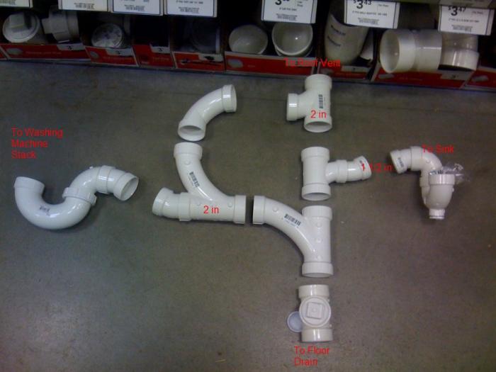

I am replumbing the laundry room in our house. I staged the fittings that I am planning on using to see if it is an okay setup. I am using a 2 inch vent (out the roof) and drain with combination tee wye fittings for the washing machine drain with a separate vent before draining vertically (also a separate sanitary tee for the sink). I am hoping this will provide excellent flow for the washing machine drain. Thanks for any pointers and checking my work/thoughts.
See attached image/link.

loose the 45 degrees between the trap and the vent, unless its on the same plane. Pipe will slope between the trap and vent , 1/4" per foot or 2% or not exceeding 1 pipe diameter.

I see, so basically just use some gradual slope instead of using the two 22.5s between the trap and vent, which give a steeper slope.
Just curious, is there a reason the 22.5s would cause a problem in the system or are they just pointless to have.
Aside from being pointless, you would be creating an S-trap, which is against code. The S-trap will have a tendency to syphon the water out of the p-trap, causing sewer gases to come back into your home

You are also creating a S trap by using the combo on the washer waste. A san tee is the better choice.
I see... I thought that it would be okay (maybe even better) since it is vented before going into the combo and down the vertical drain?! Am I wrong? Is this idea another pointless part of the setup?

Do it like this (picture stolen from Terry):
If yours will be at the base of a stack (new stack in basement or bottom floor), add a cleanout like you have at the base of the stack. Are you under UPC or IPC? Under IPC, the stack has to be a minimum of 3" for a washing machine. The standpipe and p-trap are still 2". Under UPC, 2" is fine for all of it. For the standpipe, normally it is between 18" and 30" in height, but IPC allows you to go up to 42", I believe.

The combo in the vertical stack for the washer is perfectly okay, but just more costly than a sanitary tee. The vent between it and the trap prevents it from causing a 3/4 "S" trap. The washer vent only has to be 1 1/2" and the upper turn can be a regular 1/4 bend, not the long radius one you show. At the bottom is it connecting to a "floor drain" as it says, or a "drain pipe in the floor"?

hj has the best eye of anyone on the forum! Some pointed out, and I was starting to comment, on the vertical combo. Normally, that is not used because it does create an S but taking the vent off BEFORE the combo prevents the S.
As for the horizontal line, on a branch drain, there is no limit on slope, as long as it is at least 1/4" per foot. But your situation is not the branch, it is the trap arm. Dropping it too much could cause the vent take off to be below the trap seal level. That will cause siphon, and thus is prohibited. Plastic pipe joints have enough "wiggle" that you can achieve the necessary slope without using sixteenth bends.
It connects to a drain pipe that goes into the floor in the basement. I am using 2" PVC with a gasket going into a 2" cast iron hub.
Would using a combo in the vertical pipe be of any benefit over a sanitary tee? (such as better water downflow)
