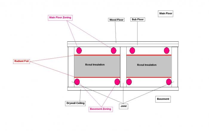

    The foil is for a radiant barrier that will be backed with Roxal insulation.
    So what I am thinking is having a sandwich type of thing within the joist space.
    They say a picture is worth a 1000 words, I don't feel like doing that much typing so I have attached a diagram.
    Let me know what you think.

    Looks right. The space between the tubing and the foil should be at least 1cm (2 is better), and the R-value of the Roxul R12 minimum (R15+ is better)
    If the basement zone tubing is stapled directly to the joists the thermal bridging of the joist will increase the interaction between the zones. To minimize thes effect hang it with standoffs rather than staples to ensure at least some gap at suspension points, and rather than parallel straight runs in the joist bay have the tubing cross over between hangers.
    Without doing a heat loss analysis it's hard to say for sure, but you may be able to get away with 1 tube per bay on the basement zone, zig-zagged between the joists.

    That is one thought about snaking the tubing in the joist space.
    One thought I had was to run 2 pipes in one joist space but use only every second one.
    Good point about the thermal bridging though. I will probably come up with some kind of plastic standoff type of thing.
    I will do a heat loss calculation before doing anything.
    I know how to do the heat loss caluc. for the room but how do I figure how much output I will have with the pex running in the joist space?

    There a professional design programs to run the numbers for you, but it'll be somewhat more heat than you're able to get through the sub-floor & finish floor above. The subfloor + finish floor puts about R1-R1.5 between the insulated cavity and room above, whereas with radiant ceiling you only have ~ R0.5-R0.75 between the warmed cavity and the room. Half the R-value delivers twice the heat flux when all else is equal...
    ...but it isn't quite equal.
    Reducing the amount of tubing by half doesn't cut the heat transfer by anything close to half, but the lower R-value of the gypsum is also somewhat offset by the lower amount of convective transfer at the gypsum-room interface as compared to what happens with a radiant floor, where the boundary layer of warmed air is constantly being displaced by cooler air sinking to the floor due to it's higher density. Most of this activity is happening at shin-level, though larger currents down glazed walls usually add some whole-room convection component.
    In very rough term half the tubing in a ceiling radiant suspended-tube would deliver at least 1/2 to 2/3 what the upper suspended tube is delivering to the first floor per square foot of ceiling or floor, and if there are rugs or furniture etc upthe radiant ceiling may exceed the total heat flux of the first floor. This isn't a simple thing to model with 3 equations in pencil on a napkin. But you probably don't need to.
    If the radiant floor above has been keeping up with it's calculated heat load at the water temp & flows you've been running, it has also been dumping as much as 1/3 of it's heat into the room below despite the foil insulation, so it's actually 30-50% or more overdesigned. Unless the basement room below has a much higher heat loss than the first floor room (not likely, but not unheard of) half the tubing in a ceiling radiant should be able to keep up. If your heat load calc comes in at something around half the BTU/square foot numbers (which it might, with minimal glazing and not much above-grade wall) it'll be at least as overdesigned as the radiant floor was. Odds are you have fewer obstructions to the ceiling too. (Have any furniture/rugs/cabinets/pets glued up there? :-) )
