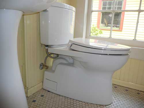

    Toto Vespin II CST474CEFG with SS114 Softclose seat.
    This bowl was installed on a 13-1/2" rough-in using the 14" Unifit adapter.
    The water shutoff can be as close as 5-1/2" to the left of center, unless it's higher off the floor, and then it can be even closer to center.
    This shutoff had been replaced with a new 1/4 turn valve with brass nipple through the wall.
    Installation was by James Love of Love Plumbing & Remodel 206-949-5683
    In some of the older Seattle homes, the old toilets had been wall mounted tank toilets.
    Those typically are 14" rough-in and need a flange repair to use standard closet bolt connections at the flange.
    Everything is on the truck for that.
    The Vespin comes with a standard 12" adapter or you can order a 10" or 14" adapter depending on your rough-in distance.
