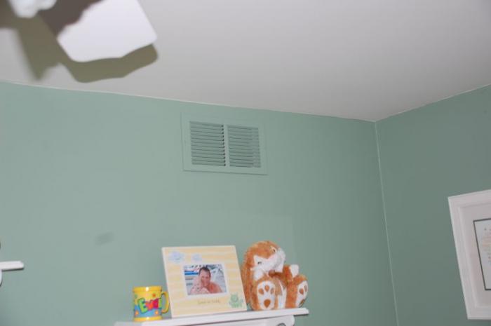

    Hello all,
    This site is the best, so I'm hoping someone can help me out with a major problem I just discovered with my forced air HVAC system.
    We've done major reconstruction over the years to our home which involved rerouting of supply and return lines. This rerouting was often not done in a very efficient manner.

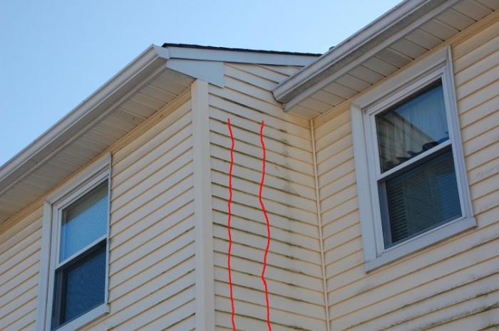

    My recent discovery was that our HVAC guy created the return in one of the bedrooms, on an outside wall. The old return ran through a downstairs wall that was moved so he moved the return. Unfortunately, for the new return, he basically just removed the existing blown insulation and used the stud bay as the return. Thus, between the bedroom and the outside air is just the grill, exterior sheathing, layer of the old shingles, and the siding. Even worse, some of these materials are cracked/broken to the point where last night I could even see a glimpse of my neighbors light from the bedroom. No doubt I am losing tons of warm air to the outside. Not good! I taped up the pinsize hole and cracked areas with a good mastic tape but it's still a bad situation.
    Thus the question... is it better to leave it as is which means I have a return but an entire uninsulated bay which gets directly hit by the NW winds we get OR better to close off that return and fill the bay with insulation?
    I know an efficient forced air system relies on the returns but it pains me to be throwing money away in heating costs with such a huge uninsulated bay which allows air flow to and from the room via the return grill.
    I am attaching two pics. The first is the grill. The second is the view from the outside. The uninsulated bay runs along that narrow vertical piece of the house. See my artistic red lines. You can see the bedroom window to the left.
    Thanks in advance!

    The hallway is basically a 6x8 area with 3 bedrooms and a small bath shooting off of that area. The two bedrooms (other than the one in question) each have a working, undisturbed return; the bath does not, the hall does not. So basically, if this return gets shut, the chances of getting return air out of this room will not be good. Not ideal. But again, like you said, neither is having such a direct route to the outside air.

    A return serves BESTwhen installed on an interior wall, but an outside wall is generally ok as long as the passage is fairly air tight or insulated.In your case it is not the best because of this leakage to the outside. Since this a "high" wall return, you could cut the opening in at the FLOOR LEVEL,thus eliminating any leakage from the higher areas of this return passage. As long as the rest of this return air passage is fairly weather-tight you will be ok
    .Note; return grilles serve best when located at floor level in the heating season, and best at the high level when in the cooling season.. but at least just having one in the room either high or low will certainly be of great help.
    if it was my home I would cut in an opening at floor level (in the same stud cavity), blocking off the upper passage, and make sure the remaining return air passage is reasonably weather-tight. If this proves to be too much work, then you could just under- cut the bedroom door an inch or so to allow any return air to be picked up by another return near this bedroom area.

    Wow, a great idea..I totally can envision what you're talking about and it'd probably only take me an hour or so. The only problem is that the bottom 3 feet or so of the wall is covered by wainscoting I installed 4 years ago. I COULD cut through it and put a low return..I'm just not ready for the punishment that my wife will give me for messing up the wall. haha.. Maybe it won't look so bad. Even if it did, I think I'd be best to give up aesthetics for functionality (and big energy savings). If that wainscoting wasn't there, I'd go start the job now.
    I agree about utilizing a high return in summer, floor in winter. We actually have a high and a low in our master which I swap covers depending on the season. I installed the high a couple years ago. Again, the wife is not thrilled with multiple holes in the wall so I never did the other rooms.

    No supply nor return in the hall. That was the original build. Below the room is a kitchen, a wide open eat in kitchen with no place to do the return. That was why the HVAC put it where he did. It was a small closed in kitchen. We busted through a wall that contained the supply (now rerouted) and busted through a wall that contained the return. Looking back, if I had known what I know now about HVAC, we would have rethought the whole idea..

    after really thinking about this problem (if it were mine) and also would be very inexpensive too, would be to cut in another FLOOR opening that will intersect this existing stud cavity and install a FLOOR return grille,making sure that the old passage is blocked off. Then in order to make the room more weather-tight I would have insulation injected /blown into this proplem wall (foam or celluloise material)

    Yes, it is pretty well the idea same as I posted earlier,but with the added fixing of the problem wall.And if you do cut in this new floor return you shouldn't have no joist in the way because the old existing route would surely be in between the joists.
    And even if by chance there was a joist in the way, then you would merely have to block two joists instead of one.A floor return grille is quite flat (no damper parts) and sitting over a joist would cause no problem.
    Just make sure these joist passages are blocked off to enable the return air to follow the same path as it did to the intake fan (furnace)

    Return air is very "smart". It will find a way back to the furnace. In most homes here, there is only ONE return grill and all the air from the house finds its way back to it. That being the case, reinsulating that stud space and eliminating the direct return would be more efficient. In addition to the heat loss through the uninsulated bay, the return air is being chilled so it adds to the load on the furnace.
