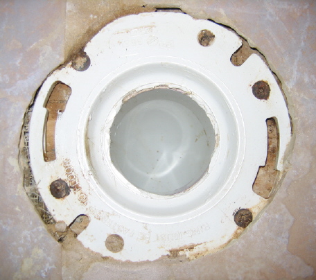

    I am replacing a toilet that is a piece of junk with a TOTO Drake. After I removed the toilet, I discovered the top of the flange is about 3/8 inch below surface of the tile floor. Furthermore, the edge of the tile cutout overhangs the some parts of the flange rim, so I do not have unfettered access to the flange. The original installation used a single wax ring with funnel, and to my knowledge it never leaked. What do you all recommend I do here? By the way, the top surface of the anchor screws in the flange appear rusted. Should I replace these? Is it normal for them to rust? This toilet was installed by the builder when this house was built in 1997.

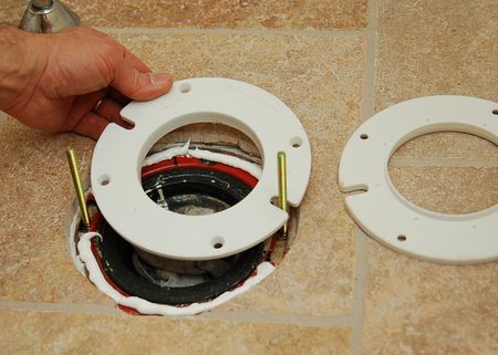

    Get a closet flange extesion kit from home depot. One extesion ring will probably get you flush with the tile. Go ahead ad replace the rusted screws with stainless steel or galvanized screws. Finally when your ready to set the toilet use a wax ring with out the funnel. The funnel will reduce the opening and created clogs.

    Or, put a regular wax down first, and then a wax with horn on top of that, and then drop the bowl down.
    Been doing that for 35 years.

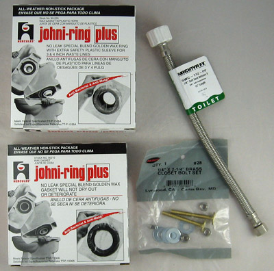

    Installing a Drake
    Install kit for toilets
    Notice that the bag of bolts includes four nuts and four washers.

    Or use a #10 wax ring which is probably thick enough by itself. I am not a fan of "extension rings" or spacers.

    Thanks for your help. I considered a flange extension but I didn't think I could do it without somehow clearing the tile completely from the rim of the existing flange. If I'm right about that then I have to figure out how to remove the tile overhanging the flange.

    Just so I'm clear, are you suggesting I put wax rings down on the flange then set the toilet down on the wax rings, or put the rings on the horn of the toilet then put the toilet on the flange? I'm guessing the latter so the ring with the funnel will be closest to the flange (bottom). In the kit you pictured in your reply, are the extra nuts and washers used to tighten the bolts to the flange before I put down the toilet? Also, do you recommend I replace the flange screws? Is there a gasket or some kind of seal below the flange? Thanks so much for giving your time to this website, this is a fantastic resource.
    14,208
    Plumbers always replace the bolts first.
    Then they put the wax on the flange, not on the bowl.
    I can't tell you how many times I've pulled a bowl that a handyman set, and the wax wax covering the hole.
    Drop the regular wax on the flange, then put the wax with the flange on top of that.
    Or you can do like hj mentions and use one #10 wax.
    I like to sell both rings, that way, depending on the home, you can use one wax or two.
    Either way, they will be able to do it.
    I have not had good luck with the white plastic extensions.
    I've had much better luck with an extra wax ring.

    What is the deal with the 4 nuts and 4 washers?
    14,208
    This is how plumbers work.
    They do it right the first time.
    They don't sell them that way at home centers.
    It's all about pennies there.
    For plumbers, it's all about doing it once.
    The first washer and nut secures the bolt to the flange.
    And the second washer and nut secures the bowl to the floor.
    A plumbers time is worth more, so anything that speeds him up is like gold.

    If you use a spacer or extension, you need longer bolts, and definitely need the extra nuts and washers to secure the spacer to the flange, after you apply a sealant between them.

    My customers get the "plumbers pack", with four nuts and washers.
    And real stainless braided, not the light weight stuff of unknown material.

    OK, Terry, I hope you don't mind me dragging out discussion of this simple job further, but I want to understand the rationale behind what I see and do. First, if you look at the picture of my flange and drain, you can see that the plumbers who installed it did some cutting around the lining of the cavity through which the waste passes- why is that? Shouldn't a flange and pipe cavity line up exactly w/o any need to cut material away? Would the cutting done there compromise the waterproof seal between the flange and the attached pipe? Do I need to apply some waterproofing to the cut edge? I removed one of the original flange screws and found that it was not just rusted at the top, but all the way down to near the tip of the threads. Is this normal after 16 years of operation, or does this reflect moisture leaking where it shouldn't? When I replace the flange screws, should I use the same size screw or go with longer or wider ones to insure they "grab" well (can you see I'm a complete novice?).

    If using two wax rings, then yes, the horn on top prevents the wax from squishing into the center.
