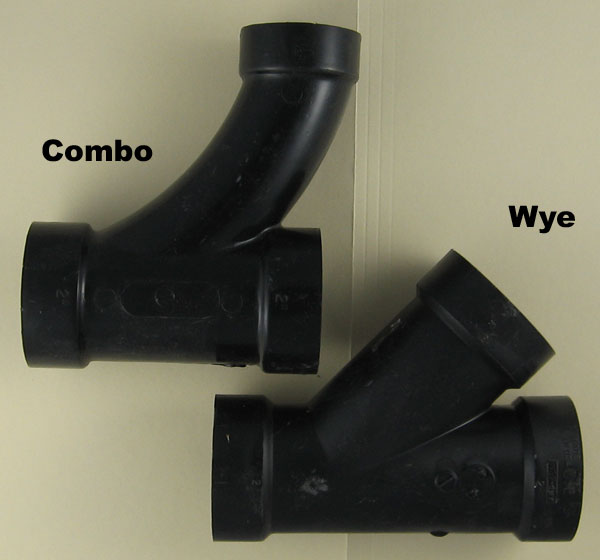

    What fitting exactly do you mean by a combo? I guess I understand the idea of using a 45 and wye to send the water in the right direction. Like this right?
    What about this long turn wye instead of the wye & 45? With the long radius ell it'd make a nice smooth turn into the drain.

    THAT is a "combo" and I use them much more often than a "Y" and 1/8 bend. Unless the plumbing is very uniquely done, there are MANY, or at least one which is all it needs, pipes attached to the riser and anchored in the walls which will support it BETTER than any riser clamps. I have cut MANY 4" cast iron risers and cannot remember any that I had to put additional supports under. NO code accepts 24" for the vent connection. Normally 42" is the standard, UNLESS you have some fixture higher than 36" in which case it has to be 6" above THAT one.
