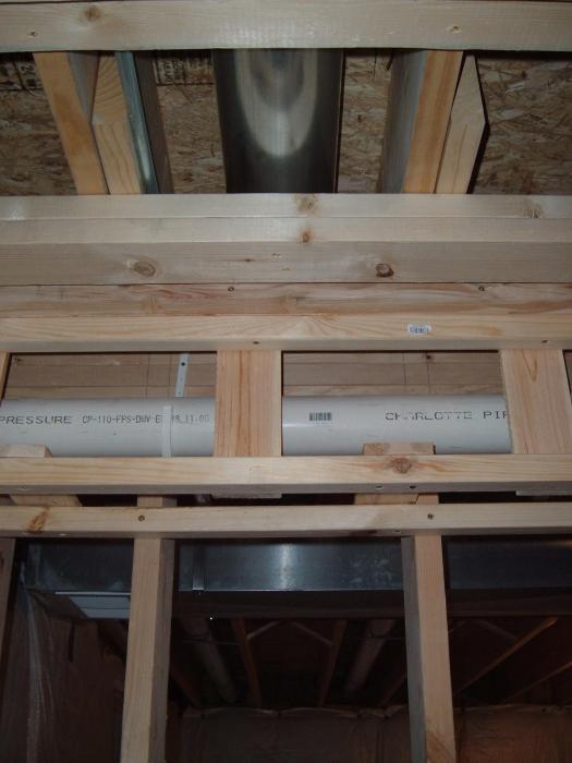

    I would like to cut into my 6" round branch supply duct and attach a boot and register for heat and a/c to a basement bathroom I am finishing.
    Can anyone tell me how to go about finding a fitting with a flange that allows me to cut into the duct, attach a round piece of duct and bring it down to the ceiling where I can attach a register?
    Also, when I look at registers at local hardware stores, the package appears to have the register, but no louvers to control flow volume. Is this a separate purchase?
    Thanks to all.

    If you do that it will seriously effect the air flow to the original register. Anyhoo. nobody makes such a fitting.

    Would it make sense in this case to use a 6" T-Saddle, screw it into the horizontal 6" round duct, extend from the saddle down to the ceiling and connect to the damper and register? I would use self tapping sheet metal screws to connect all the above and then foil tape around contact points in the duct. Thanks again for replys/opinions.

    Would tapping into the existing 6" branch round duct with a saddle and short run to a new register vs running a new duct from the main trunk make a significant or insignificant difference with regard to air flow?
    I'm trying to determine if it would be more effective to run an entirely new branch off of the main trunk to supply heat to a 10X10 basement bathroom or if I could simply tap into an existing 6" round branch running over the area of interest with a 6" saddle and drop down 8" to a new damper and register. The latter would be much less work, but I'm not sure if it would limit the air supply to the new area as well as limit the supply to the register it currently serves as compared to running a completely new duct to the new area.
    In other words, am I stealing away to much air from both registers and not serving either well by tapping into the one branch, or would it be a wash between having two registers attached to the one branch vs two separate branches.
    Hope that makes sense based on the description and photo above.
    Thanks again for replies.

    It would be much much better to run a separate duct from the main. You only get about 640cfm through a 6" round at normal static (depending on length of run and other factors) Besides that if you don't WYE off the 6" the straight through part of the run will get 90% of the air flow.
    Using a straight starting collar doesn't work either because they are not curved too fit the pipe radius.

    No matter what you decide your HVAC system only puts out so much air for the unit size. You will be robbing peter to pay paul with your air system unless you have a selective fan speed on you AHU or Furnace.
    One thing to keep in mind is if you have an exhaust fan in the toilet area you need to ensure the exhaust exceeds the supply air to the toilet or you will get some odor back into the surrounding area. So if you toilet exhaust is 100 CFM you would want to put say 90 CFM of supply air so you get somewhat a negative pressure in the toilet room with the door closed.
    Normally an 8" duct would be designed for around 200 CFM. If you have access to a Trane Ductulator which may be on the web you would normally size for .08 " loss per 100 ft or duct. For a furnace you may want to size your duct for .05" per 100'.
    Not sure what code you use but IMC says about 50 CFM EXHAUST for a toilet or urinal. You mighe want to start with that. The other approach is to rule of thumb it with a max of 1 CFM per SF but make sure that your exhaust fan exceeds the supply air.
    You are really talking about a small duct here when you look at a Ductulator. If it is a small toilet and lav (not knowing how much area) I would guess you are talking about a 4 to 6" duct.
