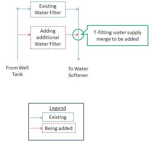

    I’m splicing in another water filter in parallel to existing filter (to double velocity).
    Does anyone foresee any problems (performance or otherwise) with merging two ¾” copper water supplies into one using a “T” fitting?
    That is, one supply will come into the “T” from the left and the other supply will come in from the bottom.
    Thanks for your input.
    Jim
    It will roughly look like this when done:

    Sorry you are confused -- perhaps the diagram is not clear that I'm adding a filter in parallel. As you probably know, doing so does not increase filtration, but will increase velocity (which is my goal).

    I see no problem except the the new filter will receive more flow that the current filter as there is a shorter path on both sides of the filter. To better balance, you could bring the feed between them with a tee and use an elbow for the new filter. Then do the same on the outlet side.
    With the current layout, the new filter may need to be replaced before the other filter as it will be a greater % of the flow (difference may be small, though).

    Thanks much. I was guessing that too -- maybe I'll just T them off evenly (but that's adding more right angles which impact flow).

    The restriction in flow due to the 3/4" T's will be negligible compared to the restriction from the filter itself. Balancing the piping on both sides is the ideal way to do it, although likely a minimal difference as well.

    There is almost NO advantage to piping it any differently than your original drawing. The flows will automatically balance themselves as one filter starts to accumulate more "debris" than the other.
