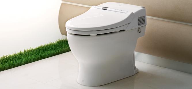

    I had decided on the Toto Neorest 500 for our remodel after my plumber said "no problem". The electrician just came to put in an outlet and said it won't support the watts for the Neorest. They had already pulled off of a bedroom for the heated floor and they said if they pull off anything else, if I plug in a vacuum, it may blow the circuit. I guess our house only has 15 amps circuits (with 20 for the kitchen). (Hope that all makes sense) They said I could an E200 or C110 washlet with a toilet, but now I don't know what to do. I had my "heart" and other things set on the Neorest. Advice please.

    I assume you don't have any spare spaces in your panel, are you maxed out on power?

    If the power requirement is like the S300 and 400, then you are looking at 1277 watts.

    Yes, we are maxed out on the power. I'm going to compromise and buy the E200 Washlet (410 watts)with either the Soiree or Guinevere. Electrician said it should be OK.

    If your panel is designed for it, and its a space issue and not a power draw issue, you can install tandem breakers which will let you install a new breaker where you couldn't before...
