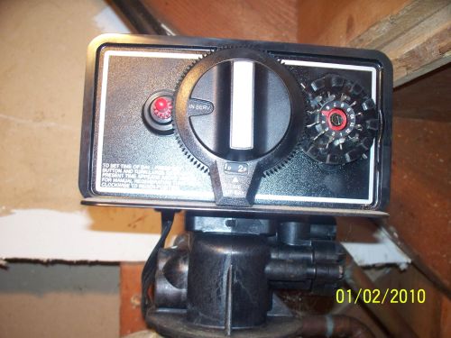

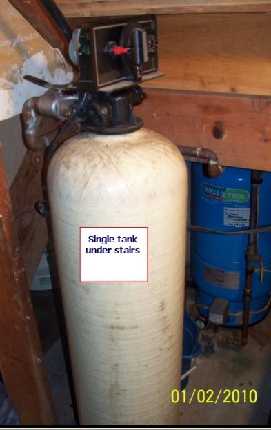

    About 4 years ago we were getting blue stains in our sinks so a company came in and removed our very old culligan water softener (2 skinny tanks, short wide tank) and installed a single tank system. They told us at the time that the old Culligan unit wasn't really functioning and that we didn't really need it anyway because all we had was low ph. They installed a single tank unit and everything was good for awhile... This is the point where I should say they have not been back to 'service' the unit in probably 3 years so I am sure that it is now probably somewhat non-functional because no media has been put in.
    I would like to try to take care of this myself if i could get some help in understanding what to do? The company that put it in seems to no longer be in business. I know I could call someone else, but again. if I could do this myself and save some money (esp this time of year) it would be a home run.
    The problem is, there is no brand or mfg information anywhere on the unit.
    On the bottom side of the timer unit the following numbers appear:
    24598-02001-010C00 on one sticker and on another smaller sticker it says:
    P/N 40278.. neither of which I could cross to anything.
    Can anyone provide any info/ guidance? I would appreciate it much!

    You have a filter version Fleck 5600 12 day time clock control valve. I don't see a top dome hole plug in the tank so you would remove the filter from the bypass valve and unscrew the control valve from the tank and add mineral and put things back as they were.
    To know what mineral you would need a water test for pH on the raw (prefiter) water. You can buy the mineral at most local independent dealers or plumbing supply house. You find either in your Yellow pages under the headings Water and Plumbing.

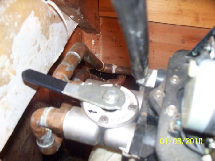

    1.) I have included a picture of behind the valve. This appears to be the bypass switch. So, to open the tank, I would first move this from 'service' to 'bypass'? How does this lever move? It doesn't seem to move very easily.. do I need to push down and turn or pull up and turn at the same time or something... or are they just a little stiff to move in general?
    2.) Once it is in bypass, then what do I do? Does the control valve turn counter clockwise like a screw top?

    4.) Also- in the info I looked at on the fleck 5600, a second smaller brine tank is always shown too... I don't have that, I only have the single tank shown in the first picture. Is that unusual?

    The bypass valve is usually pretty hard to turn if it's been sitting.
    The problem here is that you (and we) have no clue what media is in that tank, nor the water conditions that you need to deal with. At this point you should have a water test done to see what you have and then get back to us. I seriously doubt Home Depot has the correct media for your application and salt is used in an ion exchange softener which you do not have there so forget that notion.

    From the last photo I can see a Black end plug(Filter setup), meaning that there is either Calcite, Corsex, or it could even be Carbon.
    Peter is right, that handle when it has been in service for a number of years with out moving is going to be hard.. left hand on the black handle and pull to your body till it is 90 degrees or the little pointer is pointing to the by-pass..

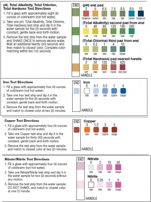

    I tested the water on bypass and using the enclosed chart (shown below). Everything was in SAFE except for PH which was a 2. That doesn't surprise me because low ph was the reason we had the filter installed. What does surprise me is the iron. I can taste it. We get yellow stain on white laundry. My wife is getting orange streaks in her hair this week? How is that possible that we measure a 0 (MAYBE 0.1) on this test? .... I have the filter in service again and I am going to take the readings again in about 5 min.
    UPDATE: After test was basically the same but I would say PH was 5.
    Confused. I was so sure the iron test would be through the roof... I thought even the test stick might disolve on that one...
