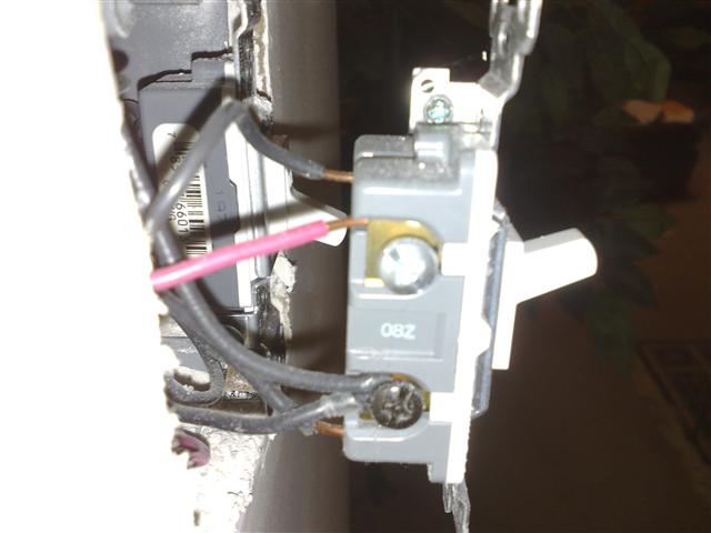

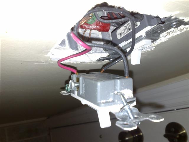

    3 way switch? I thought if you are only switching from 2 locations, then the switches were 2 way switches. I have no clue. I have pictures though. Attached.
    By the way, both switches have the black screw. On the second photo, the black screw is on the top right, hidden from view point.

    Your pictures are of Three way switches, the black screw is your common terminal. In your first picture you see the wire in the bottom is looped around the black screw. That is your power feed so the black screw on the top of the other picture goes to your light.
