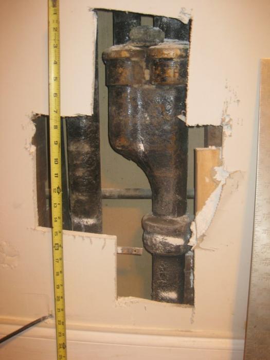

kendubya
UPC Code says nothing over 24"
The vertical distance between a fixture outlet and the trap weir shall be as short as practicable, but in no case shall the tailpiece from any fixture exceed 24" in length.
Hello, ...long-time lurker. While I know this, I cannot understand why. Would you explain the 24" limit. I'm thinking it's a dry trap potential. Thank you.
