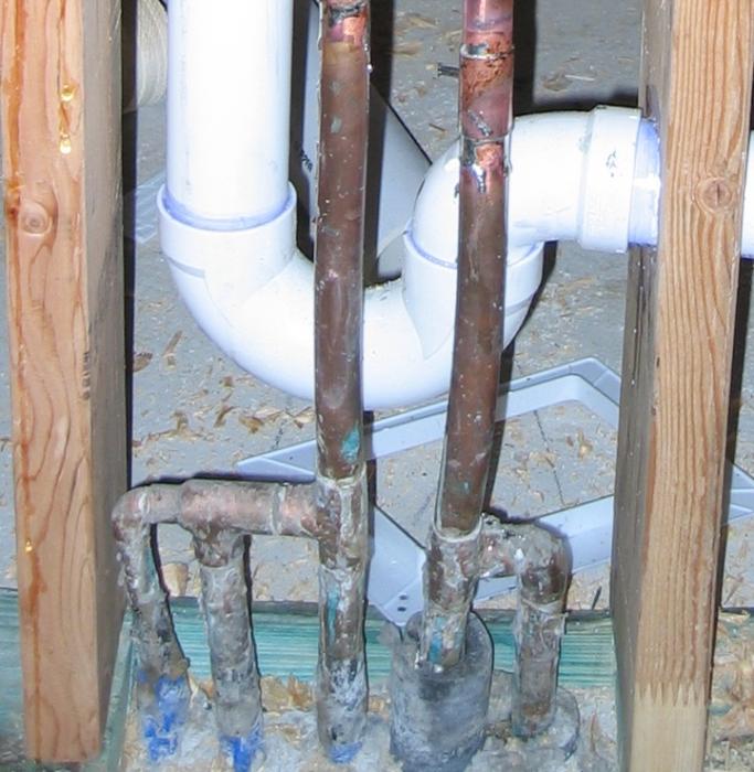

    Name:  laundry plumbing 1.jpg
Size:  72.1 KBNot a "stack" then. Here is a picture of a "manifold" in my house (but not the kitchen, this was from the laundry room but similar) Note green flux.
    Where the copper comes up through the slab they form a "manifold" with three pipes jointed (they don't join underground I assume because code disallows a joint beneath the slab foundation. So when the plumber runs out of a length of tubing during construction, he comes up above slab and builds a manifold.) There are several of these manifolds as this is a big house. There are at least 3 that go nowhere above the slab - they just continue back under. Also, the run from the water heaters to the kitchen travels through Arkansas and back to Texas. So it takes 4 minutes to get hot water at the kitchen sink. Great design....hence I need either a recirc pump or a point of use water heater under the sink.

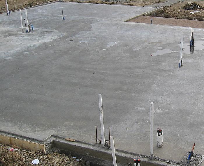

    Here is a picture of the slab before framing, the kitchen sink island position is mid upper left
    Under the kitchen sink there is a hot and cold set of "manifolds". The cold side leaked. THis is close to the Grundfos/Watts recir thermostatic "crossover" between hot and cold sides. Also, the leak is from the inside out. I found "divots" on the inside of the failed piece of pipe. The divot pattern is not a horseshoe. It is a symetrical sphere with a hole at its center (not to say it is not erosion). There are two of these divots close together. There are a inch or two beyond the 90 degree fittings of the manifold. One of the divots gave way and leaked. I will try to produce a picture and upload it here.
    I have two 50 gal gas fired water heaters in the attic. The Grundfos/Watts recirc pump sits on the second heater. There is a flex copper pipe coming from the steel nipple and runs to the recirc pump (18"). THe flex copper tube has a spot of severe copper corrosion forming right where the pipe bends. Has not eroded through yet. Does this suggest erosion? Or could it actually be electrolysis? hmmmm..
    I tried to pick the brain of the hardware store clerk who professed plumbing expertise. He suggested electrolysis maybe perhaps.
    Based on that discussion I was really thinking it was electrolysis based on the following 1)the recirc pump is not isolated with a dielectric fitting; 2) the shape of the failure point is a round divot which looks symetrical and seems electrolysis would make it so 3) the two failure points I know about are near the recirc pump and its thermostatic coupling thingey.
    So I bought a new flex copper tube (to fix the corroding one attaching the pump) along with two 100% dielectric unions to potentially create a way to isolate the pump dielectrically. The thinking being that the pump may be inducing current. BUT what does I know?

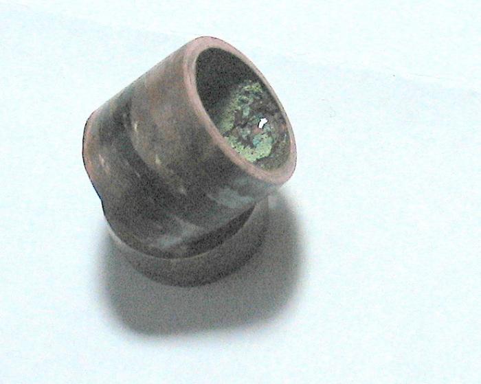

    Default corrosion erosion confusion
    best pic I can get for now shows corrosion and hole from inside out on piece I cut out

    Who did that bloody soldering?
    It's too shoddy for a DIY'er.
