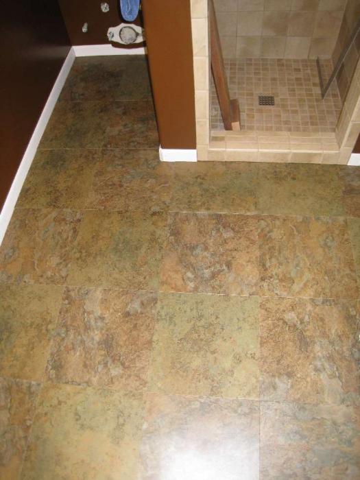

Well got the 100 ft done in the bathroom and adjoining closet this morning. I probably made too big a deal about it because it turned out easier than I expected. The hardest part was keeping some of the corners square because there actually was a variation of maybe 1/32 or so in size between tiles from different boxes. Of course Mannington says specifically to mix different boxes to get a truly random pattern. I just had to adjust by using the slightly different sized pieces in specific locations to keep my lines straight.
Glue was super easy to use and the tiles aren't too bad to trim either. Once set it the glue and pressed down by hand it would be really hard to move the tile, so I didn't worry about leaning on them to lay the next row.
Now I have to decide if I want to lay the other 1200 ft or pay a guy $0.70/ft to do it for me. I'll try to attach a picture of the bathroom later when I have my camera.

Here's a picture. Toilet and pedestal sink goes in tomorrow and then done except for the shower glass guys.

Mixing boxes with different dye lots is to randomize the color, not to compensate for manufacturing errors in tile size. I cannot imagine how anyone would be able to install tile PROPERLY if the pieces were not all the same size. There would have to be gaps between the tiles or the corners could not meet perfectly so that the tile lines would be all over the place. It would be even worse if the tiles were not square, regardless of their sizes.
