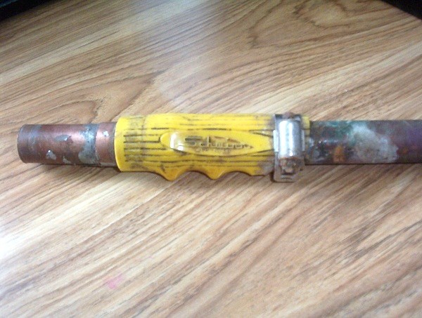

    Tell you what. If you call me for a leaking pipe I'll slap one of these on it and I won't charge you a penny. Name:  Schwinn%20Repair.jpg
    Do you want it done, or do you want it done right?
