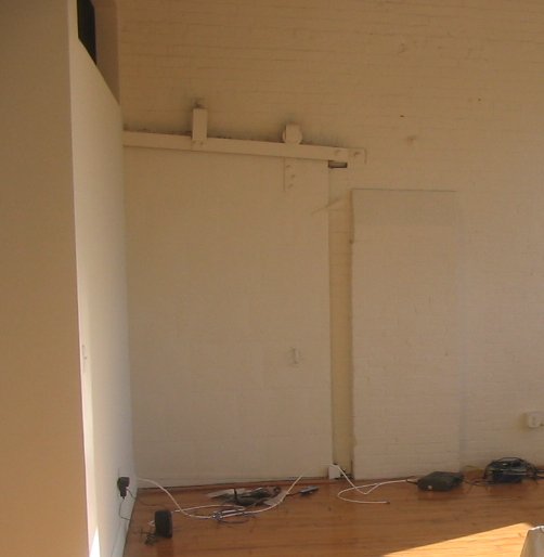

    I would very much appreciate your advice to choose the best sound proofing method to reduce the noise from my neighbor's apartment who watches TV into the early morning every night. I think it may be best to inject foam (e.g. Dow Great Stuff Big Gap Filler http://greatstuff.dow.com/ into a hollow space between a gate and brick wall:
    The setting: old factory converted loft apartments. We have a visually stunning white painted clinker brick wall with a white painted sliding gate in front that seems to be thin metal plated wood (i.e. it can be drilled). About a half of it is in our bedroom and the other half in our living room. The gate cannot be moved anymore as the wall that separates our bed and living room has cemented it in place. Because there is 4 foot step down towards her apartment the noise comes only from a 4 by 3 feet area that requires sound proofing.
    The wall with the gate must have been the end of the building before a second part was added which is now the living room of my neighbor. She is older and perhaps slightly hard of hearing and has kindly mounted her HDTV against this brick wall (we think) resulting in the space and the gate acting as a resonating body. She is unwilling to change the location of her TV and the landlord won't do anything but permits me to try insulating it myself...
    The material: From our side towards my neighbor there is a 2 inch wooden gate that is plated with relatively thin metal sheets (feels almost like thick foil or aluminum, should be easy to drill) then a 1 inch hollow space (not sure whether any fiber material is in there already but would have been hard to slide the gate over) and a 2 - 3 inch brick wall.
    My plan: drill holes in a grid pattern covering the 4 by 3 feet area with about 4 inch distance and inject Dow Great Stuff Big Gap Filler http://greatstuff.dow.com/This stuff seems to expand nicely but I don't know whether a lot of expansion equals less mass and less sound proofing. Or is bigger foam bubbles better?
    Is there any better filler? What would you do? Slap a foam pad against the outside (partially ruining the looks)?

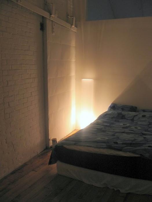

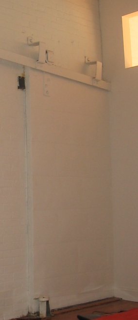

    Wow! I'm really perplexed. Glad I asked you. I was about to buy a drill and injectable foam. I had used this foam already to fill in the gaps surrounding the door. I have no idea what's actually behind the door.
    I have attached two pictures from our move in prior to arrival of furniture. You can see that there is no way to move the door.

    With a stethoscope I have now localized the noise fairly precisely to the lower third of the bedroom side of the gate. No clue why only this area would transmit.

    Thanks for the pictures. I was having a hard time picturing what you meant, and now I'm going "oh, those! I've seen those a bunch of times.
    Only way you're going to get that soundproofed, is from her side (any idea how they closed off the doorway on her side?).
    Or, put up a wall, across the whole room, closing off that door & brick wall completely.
    I suppose you could go just part of the way across the room, box back to the brick... but I wouldn't want to guarantee the soundproofing. Hard to seal against brick, compared to sealing against drywall.

    That "gate" used to be a door. On her side, there's a doorway: not brick. Maybe they closed it off with drywall or something & you've got an open space the foam would fill back there, but maybe her TV is actually mounted directly onto the back of that door.
    The right way to have renovated that space, would involved removing that door and the track, completely, and bricking up the doorway. Clearly they didn't do that, since they left the door...
    If you're trying to soundproof it, you don't just have the door itself to worry about, you also have to worry about any gap / seam between the door & the brick.
    Only way I can see to make it actually soundproof, would be to frame a new wall - doesn't have to be very thick, I'd use 1-5/8" metal framing for this - with insulation in it, and a layer of fiberboard ("soundstop") under the layer of sheetrock. You'd lose about 2-1/2 inches, in front of the current door.
