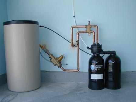

I just got off the phone (yes on a Sunday, I thought is was a customer) with a Canadian about Kinetico and the price and the BS he was fed yesterday. Something about 2+/- lbs of salt and 11 gals of water per regeneration but "no quantitative figures so he could compare to other softeners".
That would be the total salt used in a given time, like a week, or, how frequently it would regenerate. It was the toy type Kinetico with the top of the control valve about half the height of the salt tank. He's supposed to call me during business hours tomorrow. He had been reading my posts too.
