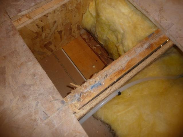

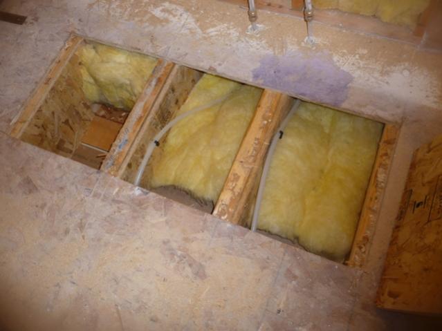

I've opened the floor in my master bath where this Rehau pex needs to be split up to accomodate an incoming double vanity.
This portion of the bath is on a 2' overhang. (Where the insulation is seen. On the portion that overhangs, there seems to be 3/4" blocking stapled to the engineered floor joists, on one side. It continues back under the floor for about another two feet.
I'm wondering if that's there for extra strength on the overhang? Anyway, the original plumber did not drill though it, (although there probably wasn't reason to do so..) so I'm wondering if I should avoid it too?
