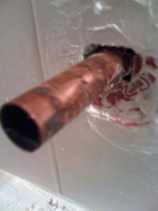

    I just purchased a new home and this handyman thing is very new to me. In the guest bathroom, I turned on the shower and the tub spout popped off the nipple. I never liked that spout anyway, so I purchased a Moen 3931 from a local plumbing store.
    I brought the new spout home and tried to slip it on the 1/2" nipple, got about half way and it got really tough. I noticed that the nipple was scratched up and a little bit bent. I also noticed that there is a nice sized hole behind the pipe that has some plastic and putty. It looks like the previous owner did a terrible job trying to plug the hole.
    Anyway, I managed to force the spout on and tighten the clamp. When I turned on the shower, water started slowly trickling out of the back of the spout into that hole (into the wall). I called a plumber and the guy they sent quoted me way too much to rip out my drywall from the other room and examine the issue. I told him to leave.
    Can anyone please help? I really appreciate it. I attached a photo so you can see what I mean.

    On that spout, you can remove the plastic slip on mechanism. It will leave you with a female thread on the inside of the spout. You can then extend and solder a male adapter (in the proper length) to the existing copper nipple. The new spout can srew into the normal male adapter.
    Any holes on your copper tubing can be soldered to plug them up. Be sure and silicone the existing hole on the wall where the nipple petrudes your wall

    There is NO WAY to keep an "O" ring seal from leaking on that piece of copper. I would get a different spout, preferably a Delta with a pull down diverter, cut off the tubing as necessary and solder a male adapter to it. Then screw the spout onto the adapter. There is NO reason to cut the wall open and a plumber could do the job in a matter of minutes for whatever his minimum fee is.

    A new peice of copper will do the job. The copper that you have is too badly damaged for the oring to seal properly.To replace that copper tube, you will have to cut the wall open. It is soldered in place
    My original suggestion is less intrusive. As HJ suggested, a plumber will be able to it without opening up the walls within 1/2 hour

    I will give a plumber a call today (different one) and have them solder on a fitting like you suggested. I'm just trying to make sure I know what exactly is going to happen, by soldering on a new fitting at the end, it will create a perfectly round hole that will seal tightly against the inside of the spout. I get that. But, isn't the Moen 3931 a slip on style - meaning there are no threads on the inside?

    Some spouts are convertible...they can be used as slip-on or screw-on. If yours is one of those (and one of the people seemed to think it is), you can remove the slip-on from the internal threads, then screw the whole thing onto a new fitting soldered to the existing pipe.

    Well. I called a plumber. He was great. Best $70 I spent. He sweated on a threaded fitting and gave me a spout.
    However, he said I could try to unscrew the pipe from inside the Moen, but it's tough. I'm trying to justify my purchase (and it was already beat up so I couldn't return it). So, I've been using pliers to try to get the pipe out, and it is in there tight! Any recommendations on how I can remove it?
