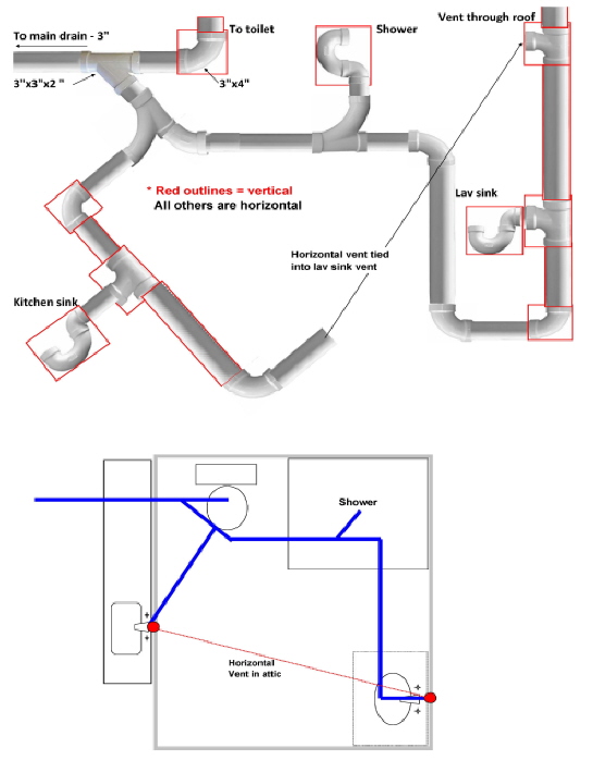

    I am adding plumbing to a room above our garage and laundry room to be able to rent out as a one room studio. The main lines & branches have already been run by a handyman/plumber friend of a friend and I've got a few concerns about the layout and whether or not I'll have problems with the venting or who knows what else. I know I definitely need to add a cleanout; don't know where the best spot for that would be either. Forget about asking the inspector to have it inspected; I tried the legal route first(getting a permit). Every time I went down to the city to double check requirements, etc., the price went up as did the requirements, which had nothing to do with the plumbing. I've attempted a diagram and looking for feedback and suggestions for improvement. Thanks in advance.

    Wet Venting is not allowed here in my state of Kentucky, which is running the drain of one fixture over another.
    It might be legal in the state you are in. Combination waste/vent systems in my area are prone to failure, which ended back in the 60's.

    Is the shower the wet vent? Could the a vent for the shower be tied with the others in the attic? I guess the toilet should have a vent too huh?

    The shower and the toilet are wet vented.
    Wet venting is allowed here but you cannot have a non-bathroom fixture in the middle of a bathroom wet vent. That requirement is based on IPC.

    The vent across from the kitchen seems to be a horizontal vent below the flood rim of the fixtures. That would be your biggest no-no . Unless the redbox is saying that the pipe goes vertical to about 42" before going horizontal

    Dunbar - Wet plumbing is allowed here - if done correctly. That's what I wanted to know, whether or not it was done correctly or not.
    psjr56 - The vent stack is at the bath sink; the shower and toilet are wet vented from that and the sink in the kitchenette will have a vent going up into the attic and tie in horizontally to the bath sink vent. I don't have enough room at the roof line in the attic to put in the vent lines for the shower and toilet in the wall behind them. What "non-bathroom fixture in the middle of a bathroom wet vent" were you referring to? My city goes by the UPC, if that matters.
    jimbo - Yes, both vents go vertical up into the attic.
    The kitchen sink. Under IPC I think it would be under 909.1 but I don't have access to UPC. It's not something that wouldn't work anyway, just one of those code issues thing. I think it came in around '01.

    Thanks for the replies. Any others? Does it look like it will work? Any problems?

    UPC did not allow wet venting for many years. I never found a house that I couldn't plumb without running a flat vent. it just takes some extra planning and of course, pipe.
    Well, I know we can't run flat vents but we can use wet vents if sized properly. It looks like you have both. It does not look like the toilet is vented to me. The vent should come off between the closet bend and the drain wye going into that line.

    dce - What is a flat vent? I was planning to add another wye with a cleanout between the closet bend and other wye. Would the wet vent I have at the lav be sufficient for the toilet or do I definitely need a separate vent for the toilet where you suggested? If I do need one, where would the best place be for the cleanout if this spot is taken? Could I put another wye off of the one I add for this vent? Thanks.
    Smile
    1) A flat vent is a vent which runs horizontally (less than 45 degrees) while it is lower than 6" above the flood rim of the fixture it is serving. In other words; a vent must have a vertical slope (greater than 45 degrees) until it reaches 6" above the fixture it is serving. Then it can run horizontally.
    2) Clean out: Replace the 3x2 wye with a 3" wye; then use a 3x2 wye for the kitchen sink and a 3x2 wye for the shower/lavy drain; put the clean out at the end of the second 3x2 wye.
    Hope that helps.
    No flat vents here. The vent from the kitchen sink will run vertically up into the attic, then horizontally over to the vent from the lav, then out the roof. (All the items boxed in red are vertical).
    Hope that helps.
    That's what I was thinking after reading your other post. Thanks!
