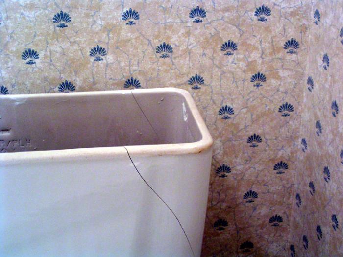

    Last week the tank on the guest bathroom toilet just spontaneously cracked. By the time I discovered it, water had spread through the slab to the wood floors in adjoining rooms. Oddly enough, an antique clock which had not run in years began to tick and chime at the same time.
    The home warranty company refused to honor my claim. The plumber said that toilet tanks do not crack under normal wear and tear and that it had to crack under physical force.
    I live alone and no one had been in that bathroom. I did not hit the toilet or stand on it. In fact, I did not touch it.
    Has anyone heard of a water closet just developing a crack out of the blue? I'd appreciate an answer so I can at least try to get my $60 back from the home warranty company.

    You best get Sylvia Brown AND Montel Williams over there, quick. Something going on in the paranormal.
    If you make a habit of leaning back on that tank, even occaisionally, it will stress crack and break.
    You have to remember that toilets are fragile and can break just under the strain of the tank to bowl bolts, the toilet flange bolts holding the toilet to the flange.
    I replaced two toilets just this year, unexpected cracks.
    I can see why the homeowner's warranty denied your claim. 1995 toilet, it's old and anyone leaning back on that toilet, even once could cause it to fail.

    Tell the warranty company you will see them in court. I seriously doubt that the plumber has any engineering knowledge with which to make such a judgement. They will have to prove you damaged the toilet, good luck to them with that.
    Where did the crack emanate from? Are we talking tank or bowl?
    They are in fantasy land if they actually believe that there are no stresses on a bolted down bowl or tank. The crack could easily have been there from before you purchased the home but did not propagate catastrophically for some time.

    Smile RE: cracked Crane water closet
    Thank you for all the answers. I mentioned the clock simply because some atmospheric quirk may have had some affect upon both the clock and the toilet..... and I didn't wish to unwittingly set off a verbal skirmish.
    The crack is in the tank, dipping down from the lip and around the side to the back.
    Now I realize that the smartest thing to do is to replace the toilet myself. That doesn't negate the fact that I want my $60 back to go toward a new unit.

    That is a very odd crack...the plumber was right based on what I see in the pic....that crack may have started some time in the past when the tank lid was put on to hard or something hit the tank and started the crack...it is possible it came from the factory hairline cracked but it would be unlikely and there would be no way of knowing...
    Does the crack go down to the tank bolt?
    It doesn't look like it does in the pic...

    Followup to my comment previous of my situation with a 20 yr Crane toilet cracking spontaneously at 12:30AM. Thank goodness we were home when it happened.
    Here are my pics. The toilet sat flush, tank not overcranked nor rocking. Not moved in over 10 yrs.
    Picked up another Toto today. I mentioned to the store owner about the tank cracking and then she asked if I had a Crane (which it is). Anyways she said they were well known for doing this...must be a certain vintage. She said I was lucky b/c there was a client who was away on holidays when the Crane tank cracked on the 2nd floor. Over $300,000 in damage! I was lucky. Not a warranty issue (too old) nor insurance (no major damage) for me.

    That is an odd place for it to shear. Looking along the tank at points that are accessible (could be struck) can you see any indication that it took an impact from a hard object? I'm thinking of something akin to a rock chip on glass. Finding that, particularly with fresh debris at the point would support the plumber's conclusion. Another thing that might support that would be an indication of a hard blow elsewhere on the tank. Without that his conclusion is unsupportable.
    For example, if there was what appeared to be a years old chip...that should be a warranty item unless the specifically exclude prior damage. Absent any indication of a point source some sort of general applied pressure to the tank (e.g. freezing in the tank before you bought it or distortion from other thicker sections/components under stress finding a weak spot above.) Any chance that the home was below freezing with water in the tank before you purchased it?

    Most likely culprit:
    Shrinkage cracks
    Started the day the porcelain was cooled down
    See them all the time
    If a customer of mine came back 15 years later about a toilet cracking I'd tell him to go buy a lottery ticket, quick...
    because they got a better chance winning that lottery than thinking I'd warrant a tank 15 years old.
    It's called the "Reasonable Man Theory" and it seems some people don't want to adhere to such standards of reasonable thinking.
