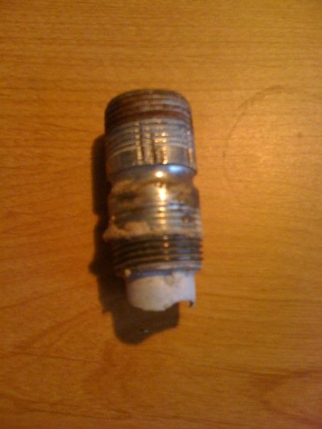

    Here ya go, folks. Broken dip tube!

    Oh, and I did need a big pipe wrench! Well, actually, I used a regular one and put a big regular wrench on the end.
    Anyway, 20 minute, $6 fix. Not bad. Now, I just sit and wait for the bottom to rust out, right?!

    Quote Originally Posted by adamw View Post
    Glad to hear that was it. Is that a metal dip tube or plastic? I'm wondering if it was acting as a sacrificial metal... Did you also do the anode or check it?
    Jun 2009
    Penticton, BC
    812
    Quote Originally Posted by Runs with bison View Post
    It's plastic.

    Plastic. And no, I didn't check the anode
