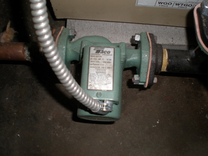

Circulator
The circulator running should keep pipes from freezing up.
I disconnected the thermostat. Tomorrow's outside temperature is forecast to be 9 degrees. How do I keep the circulator running?
Is there a circulator for each zone? Depending on how the system is plumbed, you may not be able to run the circulator without supplying that zone heat. Without seeing it, it would be hard to tell.
Normally, the zone comes from the hot outlet of the boiler through the radiators, and back to the cold inlet of the boiler, pushed by the circulator. If there's only one, then the loop is controlled (opened) by a zone valve. Even if it has its own pump, unless special piping was installed and by-pass valves, there may not be a complete loop to run the water without running it through the boiler (and therefore heated).

I reconnected the thermostat early this morning. Is it possible to leave the thermostat wired to the circulator but disconnected from the boiler? I'm thinking this way the circulator would circulate but the boiler would not fire. Or does the boiler kick on when the store of water in it drops below a certain temperature and not when instructed by the remote thermostat? The system is not plumbed to bypass the boiler.

My boiler does kick on when it calls for heat
And when the Temp falls below a certain point
What is the lowest setting for your thermostat ?
I've seen some that go down to 40/45
I'd think that's as low as I would want it to get
If you are losing that much heat keeping the Temp low then you need to insulate, replace the windows, or seal up leaks....or all of the above
Some boilers can run from cold...some maintain some minimum temperature, regardless of the call for heat. When there has been no call for heat for awhile, what temp is the boiler water? This is normally controlled by an aquastat. It sets the min/max of the boiler.

The remote thermostat for the zone I want to shut down is a mercury triggered type with a minimum setting of 50 degrees. I thought of skewing the horizontal alignment of the mounting to over ride the settings. Anyone ever done this?
I am not familiar with the aquastat. Is it adjustable? The boiler is a Weil McClain Gold and about three years old. Can I disconnect the thermostat from the boiler and leave it connected to the circulator?
