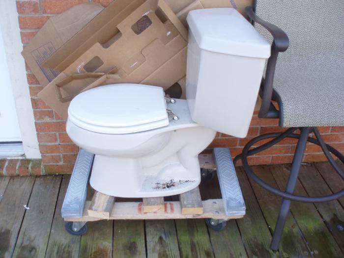

I drained and pulled the old toilet. I remembered that I had a dolly, so I quickly transferred the old toilet to the dolly…a great back saving move. I rolled it out the back door onto the deck. I’ll call Habitat Restore to see if they want it.

The image is of the old 3.5 gpf toilet on a dolly.
